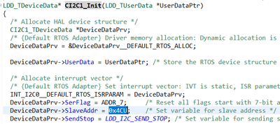

I am trying to communicate with a temperature IC using the I2C of TRK-KEA8, the slave address of the temperature IC is 0x4C,
but the code generated by Components-DGP_LDD can only send 0x98,
I have tried the following three methods but they were all ineffective:
1. Changing the I2C_LLD setting in Components Inspector to 0x4C or 76, did not work.
2. Adding the SelectSlaveDevice instruction in the program, did not work.
3. Directly modifying the values inside CI2C1_Init() initialization, did not work.
Are there any other methods or have I misunderstood or missed anything?

I2C puts the read/write bit in the lowest bit, so addresses get shifted to the left. 0x4C * 2 = 0x98.
Some data sheets give the shifted value others give the unshifted value for the device's address. You may really need to enter 0x26 = (0x4C / 2). Always a point of confusion with I2C.

Hi Bobpaddock
Thank you for the detailed explanation, it is very helpful to me. Thank you.
