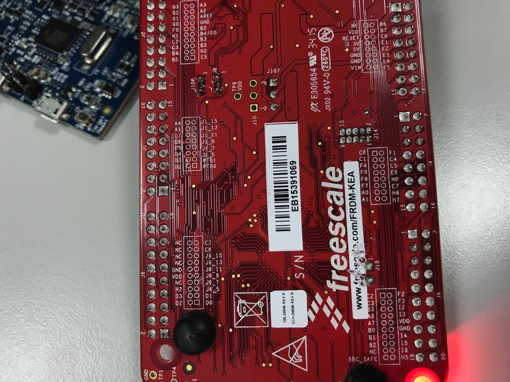

I purchased a FRDM-KEAZ128Q80 from DigiKey. The OpenSDA portion of the board appears to be nonfunctional. The demos work if I connect a 12V source, but connecting a USB cable doesn't power the board or enumerate with a computer. When connected only to USB, I can probe that power is getting to the OpenSDA MCU, but the main power busses are not on. Is my board just defective, or am I missing something obvious?

Thanks for your help. This is my first foray into the world of Cortex and NXP KE, so my apologies if I'm missing some thing straightforward. I was under the impression that the secondary microcontroller attached on the circuit board, the one connected to USB, was pre-burned with firmware to act as a programmer/debugger for the main microcontroller, the KEA128.
Since my original post, I've received a second replacement board from DigiKey, and it acts the same way. In both cases, the demo application on the KEA128 appears to work properly when connected to an external power supply, but the programmer/debugger and USB interface seem to be nonfunctional.
a. How can I verify the bootloader? I was expecting that the board would appear as a mass storage device and serial port out of the box. Currently, none of the LEDs light up at all when connected to USB, including the OpenSDA LED.
b. My board only has a single microUSB connector, and I'm connecting to that one.
c. I probed a few test points on the board to see if the USB connector was bad. P5V_SDA and P3V3_SDA have power, but P5V0 and P3V3 do not.

The J107 jumper is connected to 2-3, I did try 1-2 also. None of the LEDs on the boards come on when they are connected via USB. For host devices, I've tried Windows 10, Windows 7, MacOS, and connecting directly to a USB phone charger.

I followed your instructions and installed the drivers on Windows 7, however, neither board appears as a device after reset. Nothing shows up in Device Manager, and there are no new drives that appear. Here's a video--you can see that there are no LEDs on at all when connected via USB.
https://drive.google.com/file/d/11OEOkk-AXcoV-C5sa_Y-b12mdOltZTeQ/view?usp=sharing
I suspect the programming/debugging firmware was never loaded on these boards. Would that make sense, and, if so, is there a way to program them without additional hardware?

   Please check J107 on your board, you need to connect pin2,3.
  If you just connect the USB cable, whether your D2 is lighting or not?
 Please also tell me what the PC operation system you are using?

I've had a lot of issues with FRDM boards initially. Some bootloaders (like DEBUG-APP_Pemicro_v102.SDA) do not enumerate the board on connection to USB. Also some boards do not come with the example application burned, hence the only LED that will light up is the OpenSDA LED.
Therefore, a) make sure that you have the correct bootloader burned. b) make sure you're using the SDA onboard USB port. c) How exactly did you measure the "main power busses"?
