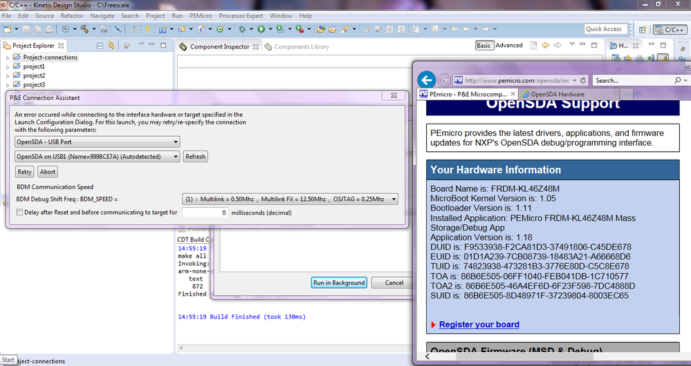

I have been trying to use Kinetis to debug KL46Z256 and I receive an error:
What I have done so far:
1. Install on different operating system
2. Update the bootloader
3. Update the kinetis

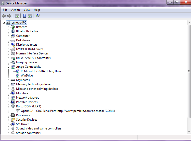

4. check the KL46Z256 drivers.
5. Change the cable and USB port
6. Change the kl256 with a different kl256
7. I get a similar error with Code Warrior as well.
I can program KL256Z with the mbed online compiler and no problem.
Can anyone help?

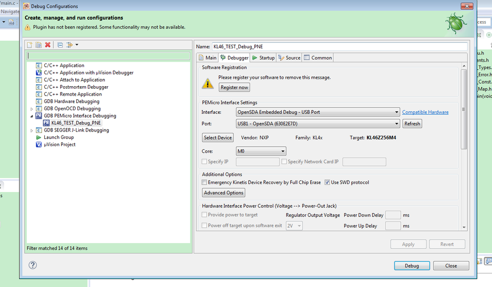

Hi Bee Zee,
   Thank you for your updated information.
   I think you modify the FRDM-KL46 board before, because, when the FRDM-KL46 out of factory, the J18 is connect.
  If J18 is disconnected, normally, use the on board debugger to program the external chip.
   Now, if your problem is solved, please help to mark the correct answer, just to close this case, thank you!
Kerry

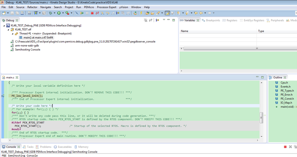

kerryzhou
Hi Bee Zee,

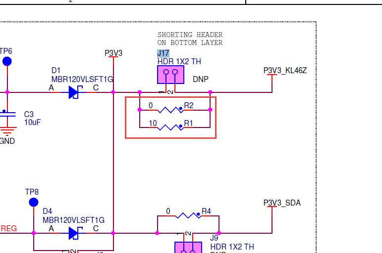

   Do you mean you are using FRDM-KL46 board, just use the on board debugger, and program the debug as the opensda, but this on board opensda can't program the on board KL46 chip? Or you can't program the external KL46 chip?
  Please help me to confirm the question.
I have test my FRDM-KL46 board, use opensda firmware, it works OK.
Please check your FRDM-KL46 board, you must make sure j17 is short, or R2, R1 is connected.
This is my test result:
You can try my attached project, then test it on your FRDM-KL46 board, if you still have problem, please let me know.
Kerry
3,015 Views
beezee
Thanks, your advice helped me to find the problem. J18 was disconnected on FRDM-KL46Z so I connected it.
Bee Zee
