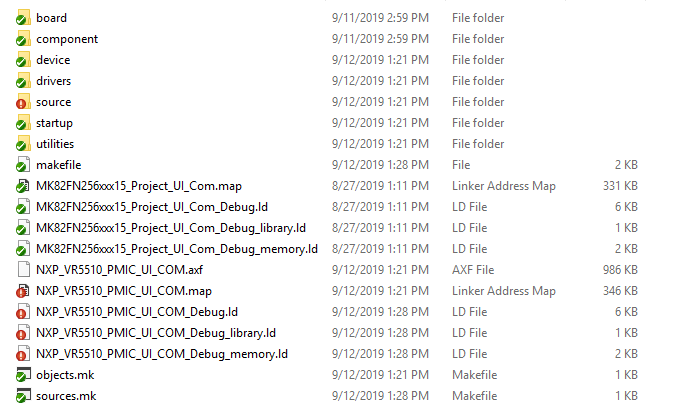

I am not able to locate any .bin after build in my project folder. However if i use MCUXPresso IDE to flash after build, I can see my modified code is getting flashed and executing.
My project folder is looking like below:

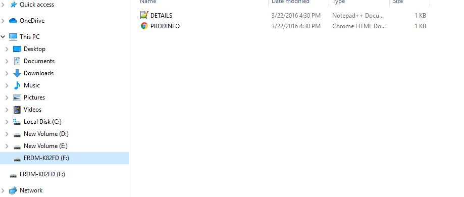

And the FRDM board when connected to my PC appears as below, is it expected?

Robin_Shen
Hi Vivek,
Please refer: MCUXpresso IDE: S-Record, Intel Hex and Binary Files
Robin
