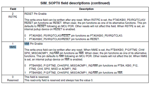

NMIE in System Options Register (SIM_SOPT) is already set to 0 in code but it seems to have no effect when CPU starts up.
I have tried to move setting NMIE in SIM_SOPT from MAIN() to start() (earlier in code), but this change has no effect.
It seems that NMIE does not work correctly?

You must disable it in the "flash configuration" block so that it is valid out-of-reset. Code will not be able to stop a pending interrupt because the interrupt will be taken before the code has a chance to run.
The Flash configuration block is the area 0x400..0x40f in Flash which can be filled with protection, security and options that are vaid when the chip starts out of reset.

I thought that I copied the FOPT table from the KE04 user's manual but I must have taken it from the KL04 by mistake (sorry). There don't look to be options here for the KE04, therefore I think that you have only two options:
1. Ensure that the NMI line is always pulled to '1' at reset.
or
2. Add an NMI interrupt handler (in flash based vector table) which will immediately be called, which then disables the NMI function and returns so that the booting can continue normally.

I have added a NMI interrupt handler where I added following code:
void NMI_Isr(void)
uint32_t    u32Soptbl;
    u32Soptbl = SIM->SOPT;
    u32Soptbl = u32Soptbl & 0xFFFFFFF8; //disable NMi and reset.Bit 0 is reserved.
    SIM->SOPT = u32Soptbl;
And it works perfect. Now the CPU starts correctly and does not hang.
Thank you for the tip.
