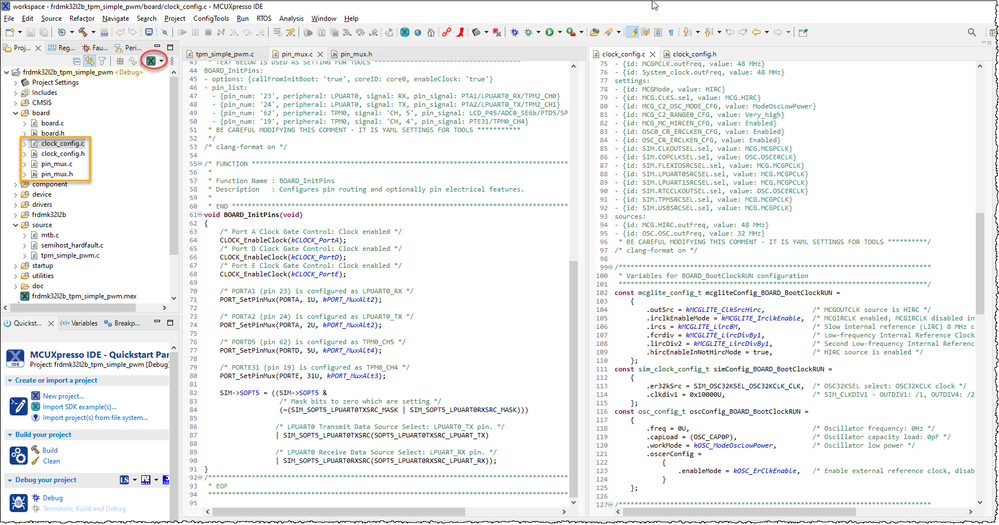

I have a fairly simple C based application I've developed using the UARTs and some GPIO on that board, it works fine.  However I wanted to add PWM output to one of the GPIOs.  The sample project tpm_simple_pwm.c works fine and generates the expected PWM output signal on the green LED output on the board.  When I try to cut and paste that exact file into my custom project and run it, I get no PWM output on the pin however, just a constant voltage of about 1.5V.
Are there any additional settings I should be carrying over from the tpm_simple_pwc project into my custom project to get PWM output working?

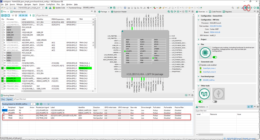

Hi smachin_kinematics,
Can you tell me which pin you need to output the PWM waveform on?
Besides tpm_simple_pwm.c, you may also need pin_mux.c.h and clock_config.c.h generated by Pins Tool and Clocks Tool
pin_mux and clock_config.pngpin_mux and clock_config.pngPins Tool.pngPins Tool.png
If you use your MCUXpresso Config Tools in your project, then no need to copy them.
Robin
