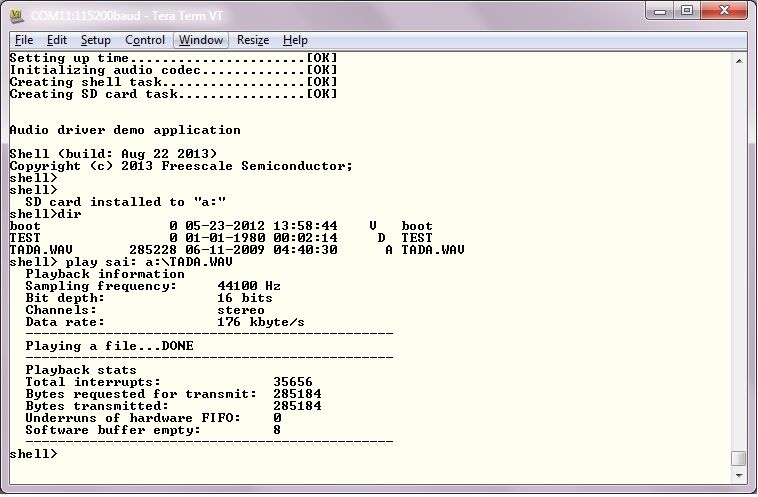

Nvm, I've got the sample code @ C:\Freescale\Freescale_MQX_4_0\mqx\examples\i2s_demo\cw10\i2s_demo_twrk70f120m running.
I need to enable the BSPCFG_ENABLE_SAI @ user_config.h and recompile the BSP again. Next, i recompile the i2s demo code.
After that, hook up both theTWR-AUDIO-SGTL and TWR-SER  to the TWR system, connect the serial cable from the TWR-SER @ 115200
and  place the SD card (containing a sample wave file) into the main TWR board.
Then from Teraterm: SAI.jpg
