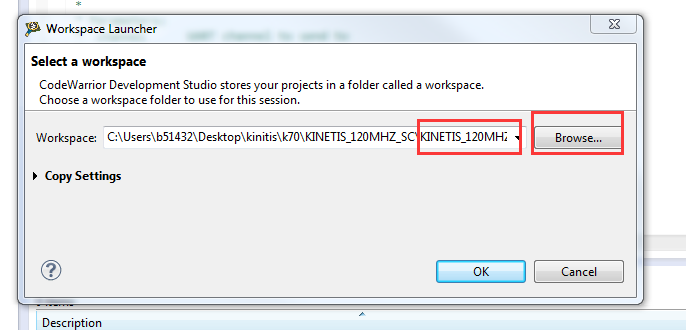

Hello Minmin,
There is kinetis 120MHZ bare metal sample , it support the chip K60FN1M0xxx12 on TWR-K60F120M board:
Kinetis® 120MHz bare metal sample code
Pay attention, if you run it on CW, please use the " KINETIS_120MHZ_SC" folder as workspace:
then import the demo and build .
Hope it helps

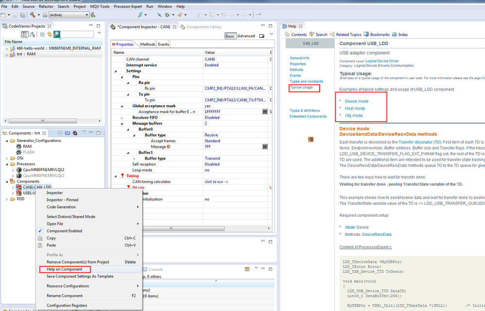

Hi Minmin,
There are three methods you can try :
1. Under "KINETIS_120MHZ_SC", there is USB demo based on IAR, you can use IAR or porting it to CW by yourself.
2. Create PE project on CW by choose "Processor Expert" :
then add CAN component or USB , there is typical usage you can refer to :
3. You can also create new bard board project, then copy the code for K60 under CW to your project .
Hope it helps
TIC

Dear Minmin,
About how to create Processor Expert project , please refer to "ProcessorExpertHelp.pdf"(CW MCU v10.7\MCU\Help\PDF) -> Chapter 4 Processor Expert tutorials
Alice
