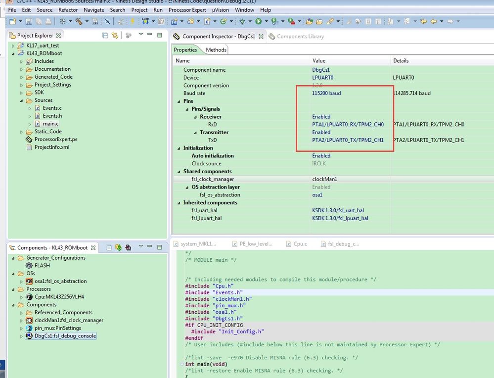

2.1.1 Create KDS KL43 project
The new KDS PE project creating is very simple, here just describe the important points which is relate to the UART problem after booting from the ROM. At first create a new KDS PE project which is based on KSDK1.3.0, and choose the chip as MKL43Z256VLH4, select the MCG mode as HIRC, and configure core clock to 48Mhz, bus clock to 24Mhz.
Then add the uart module fls_debug_console for testing, because the FRDM_KL43 is using PTA1 and PTA2, the console module can be configured like the following picture, after the module is configured, press the code generation button to generate the project code.
Then add the simple code in file main.c main function for testing:
char a;
for(;;)
                PRINTF(" test!\n");
                a= GETCHAR();
                PUTCHAR(a);

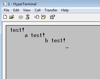

The code function is: printf the “test!” to the COM port in the PC, then wait the uart data, if receive the data, then printf the received data back and run this loop function again.

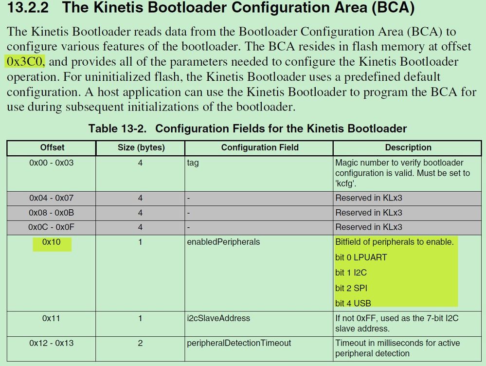

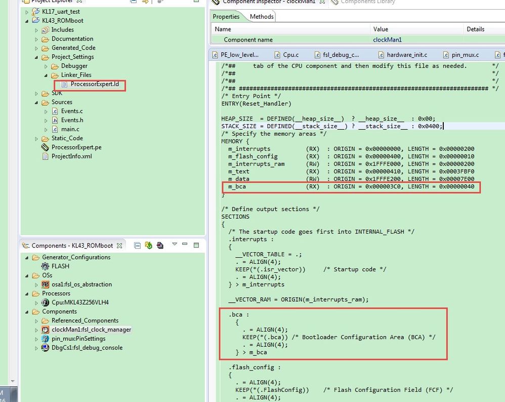

2.1.2 Add the BCA area
   From the KL43 reference manual, we can get that, BCA start address is 0X3C0:
    The KDS newly created project didn’t contain the BCA area in the link file, so we need to add this area in the link file and add the BCA data in the start file by ourselves.
2.1.2.1 Divide the BCA flash are in .ld file
Add the following code to define the BCA start flash address and the flash size in the ProcessorExpert.ld memory area:
m_bca                 (RX)  : ORIGIN = 0x000003C0, LENGTH = 0x00000040
Then add this code in the SECTIONS area:
  .bca :
             . = ALIGN(4);
             KEEP(*(.bca)) /* Bootloader Configuration Area (BCA) */
             . = ALIGN(4);
           } > m_bca
At last, the ld file is like this:

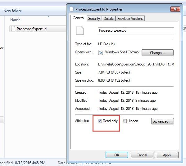

For the ld file protection, we can change the ld file properties to read-only, then this file won’t be changed to the initial one after building.
2.1.2.2 Add the BCA data in the start file
     After add the BCA flash area divide code, we still need to define the BCA data in the start file:
   /* BCA Area */
    .section .bca, "a"
                .ascii "kcfg"                            // [00:03] tag
                .long 0xFFFFFFFF // [07:04] crcStartAddress
                .long 0xFFFFFFFF // [0B:08] crcByteCount
                .long 0xFFFFFFFF // [0F:0C] crcExpectedValue
                .byte 0x03                                             // [10] enabledPeripherals  I2C and UART
                .byte 0xFF                                              // [11] i2cSlaveAddress
                .short 3000                           // [13:12] peripheralDetectionTimeout (milliseconds)
                .short 0xFFFF                        // [15:14] usbVid
                .short 0xFFFF                        // [17:16] usbPid
                .long 0xFFFFFFFF  // [1B:18] usbStringsPointer
                .byte 0xFF                                              // [1C] clockFlags
                .byte 0xFF                                              // [1D] clockDivider
                .byte 0xFF                                              // [1E] bootFlags
                .byte 0xFF                                              // [1F] reserved*/
   More details, please refer to this picture:
      So far, we have create the FRDM-KL43 test project which contains the BCA area, and boot from the ROM that can be modified in the flash address 0X40D, bit 6-7 in 0X40D is the BOOTSRC_SEL bits, 00 boot from flash, 10 and 11 boot from ROM, more details about the FOPT, please refer to Table 6-2. Flash Option Register (FTFA_FOPT) definition in reference manual.
2.1.3 Test result and analysis
      Now, list the test result after booting from ROM or flash, and boot from ROM but enable the peripherals.
Boot from:
ROM peripheral
Test Result
Flash
XX
OK
ROM
0XFF, enable all
NO, UART can’t receive
0X08, enable USB
Yes, UART can receive
0X04, enable SPI
0X02, enable I2C
0X01, enable LPUART
     From the test result, we can reproduce the problem. The UART receive problem just happens on booting from ROM and the LPUART is enabled, when we run it with debugger, and test it step by step, we can find after the PTA1 have received the data, the code will run to the abnormal area.

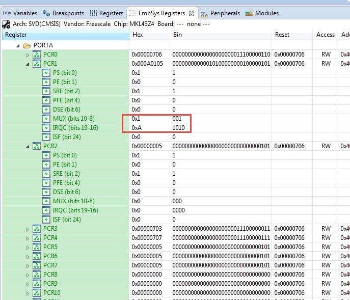

Checking the PORTA register before do the cpu and peripheral initialization, PTA1 is enabled the port interrupt, and choose Flag and Interrupt on falling-edge.
    This can tell us why the PTA1 pin have the problem of uart receive data or give a falling edge in PTA1 will run abnormal, because in default, even we configure the PTA1 as the uart receive function, but the code didn’t clear IRQ and NVIC register, when the signal happens on PTA1 pin, it will caused the PORTA interrupt, but we didn’t add the PORTA interrupt ISR function, it is also not useful to us, then PC don’t know where to go, so it will run abnormal, enter the defaultISR, and can’t recover. If you have interest, you can add the PORTA_IRQHandler function, you will find the code will run to this function.

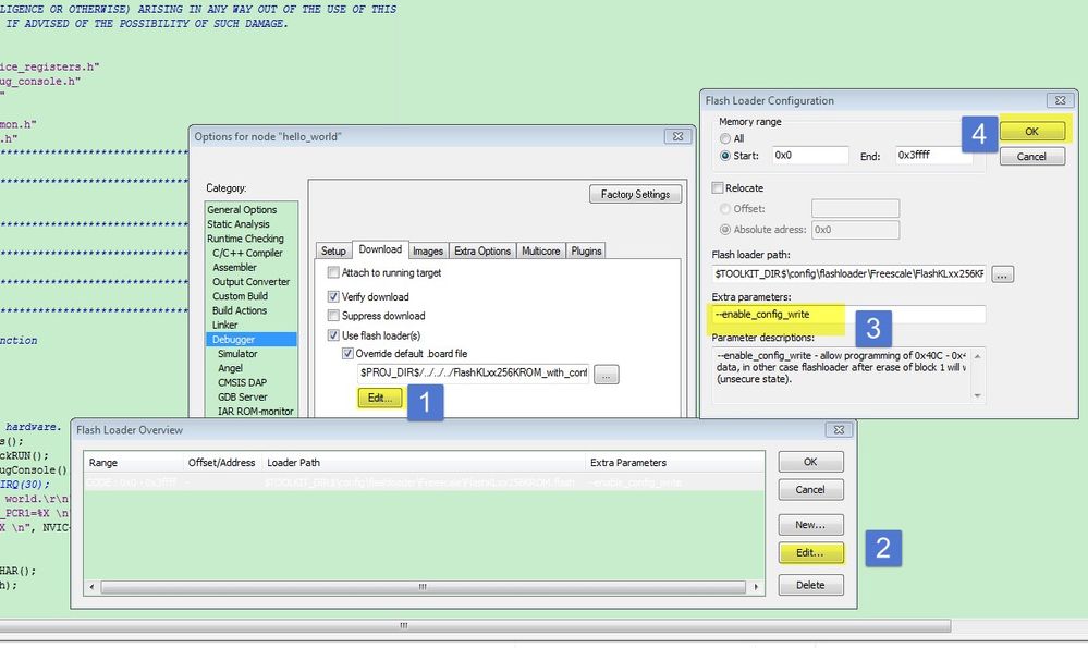

  Because the IAR IDE will protect the 0X400 area, then if we want to modify the FOPT, we need to modify the .board, add –enable_config_write at first.
 Then modify the FOPT in startup_MKL43Z.s:
__FlashConfig
        DCD 0xFFFFFFFF
        DCD 0xFFFFFFFF
        DCD 0xFFFFFFFF
        DCD 0xFFFFFFFE   ; 0xFFFF3FFE
__FlashConfig_End

Hi, I have the following comment from a customer.   Can it be reviewed for possible update to DOC-332389?
I actually disagree with the solution shown in DOC-332389 because they are using an over simplified test case.  Their proposed solution to block the port pin interrupt from the LPUART Rx pin was to do this:
NVIC_DisableIRQ(30); //disable PTA interrupt
This goes to the NVIC and disables interrupts from *all* pins on port A.  If you want to get an interrupt from any of the other pins on port A, you have to go back to the NVIC and re-enable the PTA interrupt which would allow the same unhandled interrupt to occur.  Since we are trying to avoid an unexpected interrupt on a specific port pin (PTA1), I believe a better solution is to do the following where “gpio” is what is needed for modifying PTA1:
PORT_HAL_SetPinIntMode(gpioGetPortPtr(gpio), gpio->pinIdx, GpioIrq_Never);
It is correct that BOTH NVIC source and pin source need to be disabled to avoid the risk of an unexpected interrupt possibly taking place when the application uses these features.
