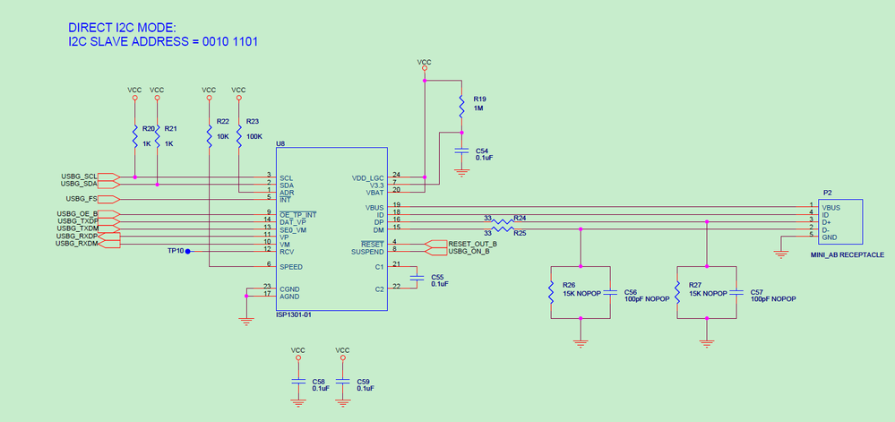

Hui_Ma
We had a i.MX21 application with ISP1301 as USB OTG transceiver (integrated charge-pump).
Please check below schematics for the detailed info:
Wish it helps.
Ma Hui
