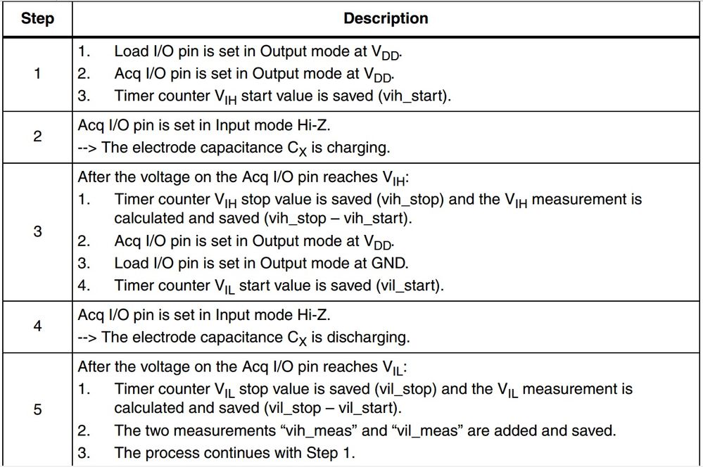

I am using MKE04Z8VTG4 for capacitive sensing application using RC acquisition principle.
Sensing electrodes are connected on PTA2 and 3 and I am using KBI interrupt to measure the time.
I do not know how the KBI settings will be effected if I change the sensing pins to output (no changes to the KBI registers will be made)?
For example first I initialize KBI module and sensing pins as output. Then I start the sequence described in the pictures.
Basically I have no idea how the KBI works as this is the first time I am using it. And I do not know if there will be any problems with the KBI module (for example false interrupt execution) if I change the sensing pins to input/output or if I will have to reconfigure it when I change the sensing pins from input to output.

Hi Jure,
I think it can't work out.
If you have already set the PTA2 and PT3 as the KBI pin, it can't be GPIO pin simultaneously.
Hope it helps.
