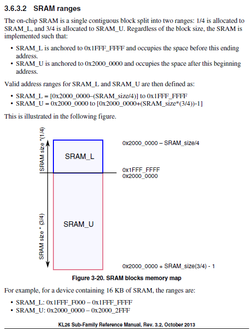

memory_map_entry_t g_memoryMap[] = {
    { 0x00000000, 0x0003ffff, &g_flashMemoryInterface },   // Flash array  (1024 * 256)
    { 0x1ffff000, 0x20006fff, &g_normalMemoryInterface },  // SRAM (SRAM_L + SRAM_U) for 32Kb SRAM
and   remaining array will remain same..

mjbcswitzerland
Specialist V
Harsh
256k Flash / 32k Ram KL requires:
    { 0x1fffe000, 0x20005fff, &g_normalMemoryInterface },  // SRAM (SRAM_L + SRAM_U) for 32Kb SRAM
If you however have a boot loader running on a 128k/16k part you can use that - there is no need for changes in the liker script file (it will run the same in the original area of RAM).
Mark

harshpatel
Thank you Mark
May i know why SRAM config for (256 flash/32Kb RAM )is..
rather than...
{ 0x1ffff000, 0x20006fff, &g_normalMemoryInterface },  // SRAM (SRAM_L + SRAM_U) for 32Kb SRAM   ??

mjbcswitzerland
Specialist V
Harsh
This is standard information - you just need to look in the KL26 User's Manual:
