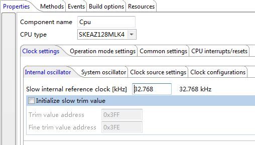

We are still struggling with this problem.

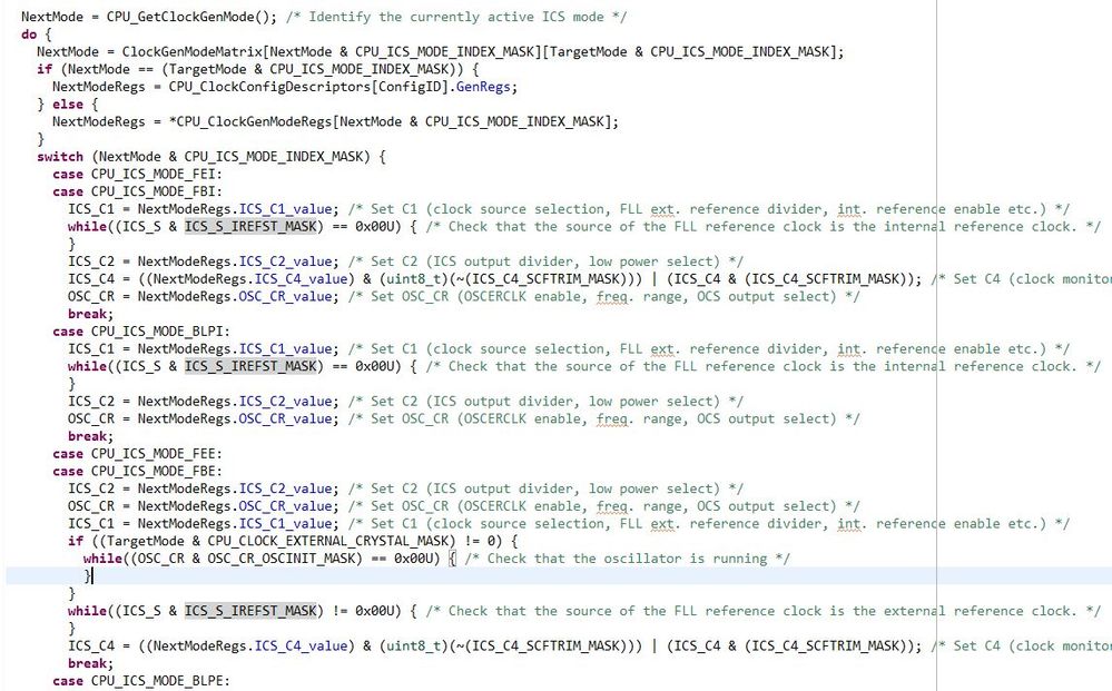

The new progress is that we used a USBCAN analyzer to connect with one TRK-KEA128 board, and we surprisedly found that the baud rates of the CAN signals from this board are 140.35kbps, 141.18kbps, 142.011kbps, 142.86kbps, 145.45kbps with 124.83kbps configured in KDS2.0 (125kbps is the target). We guess that this is caused by the internal clock, then we moved to use the external clock on the board. However, we encountered another problem: the KDS cannot complete the PE initialisation by entering into a deadlock because there are no clock signals on the EXTAL and XTAL pins (this is confirmed). The following is the code fragment generated by the PE:
        if ((TargetMode & CPU_CLOCK_EXTERNAL_CRYSTAL_MASK) != 0) {
          while((OSC_CR & OSC_CR_OSCINIT_MASK) == 0x00U) { /* Check that the oscillator is running */

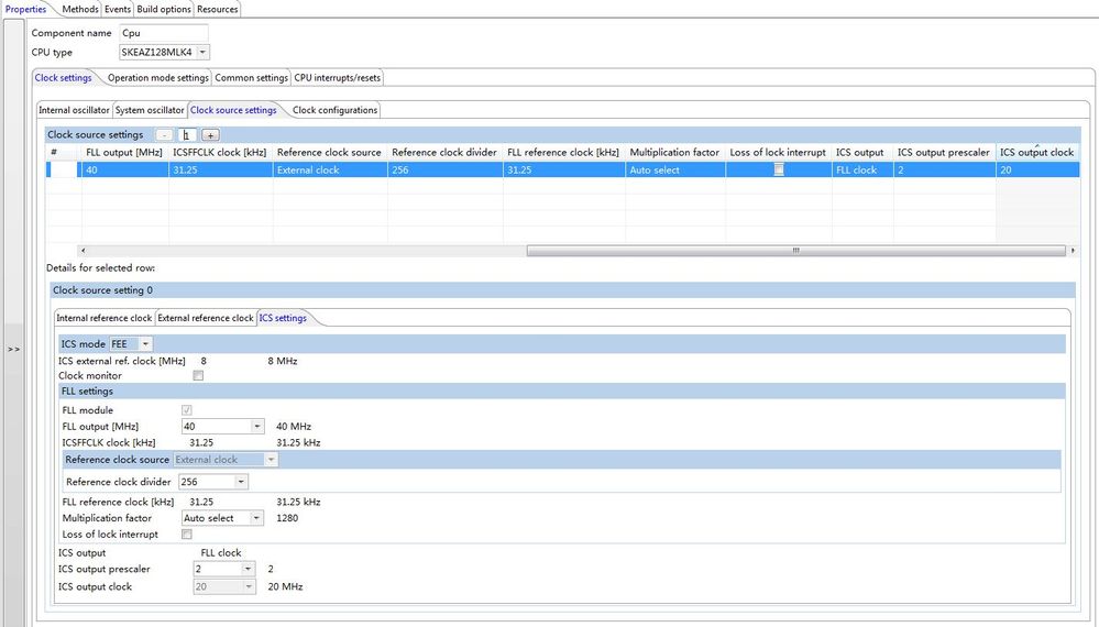

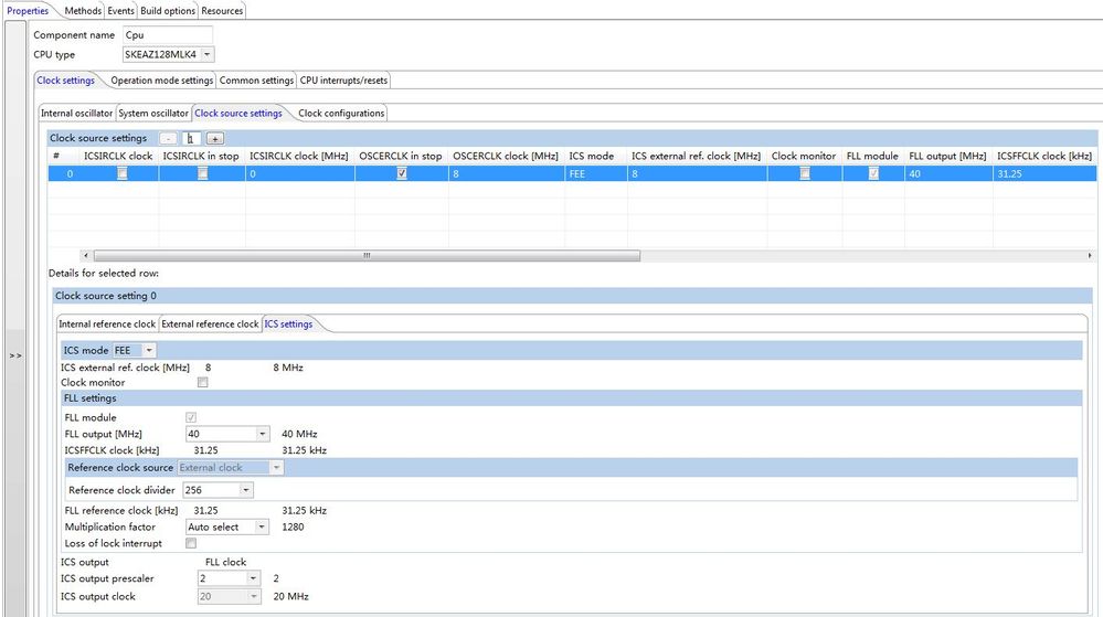

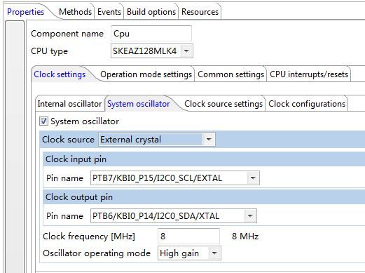

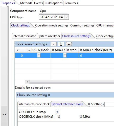

Please refer to the attachment for details.
The attachments also contain the external clock configuration.
ClockConfig.JPGClockSourceSettings.JPGClockSourceSettings-2.JPGClockSourceSettings-3.JPGInternalOscillator.JPGSystemOscilator.JPG
