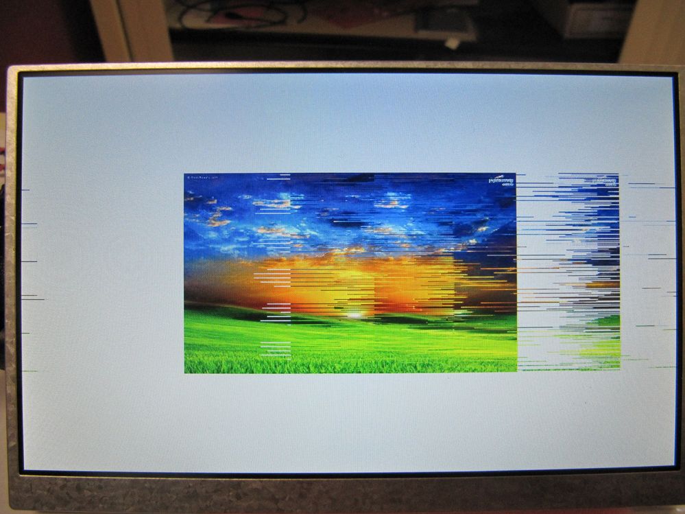

I have the tower K70f120m.
I'm using Codewarrior v10.3 and MQX (4.0 or 4.1)
I have the PEG lite (Free on Kinetis)
And I use an LCD screen 800x480
I try the "Hellopeg" exemple provided with the PEG software.
I adapted the twrlcdrgb_k70_16.cpp file for my specific TFT screen.
1) Hellopeg with Codewarrior in standalone (No MQX):
When I swith display from picture to another, following function is called: K70_TWRLCDScreen::MemoryToScreen
This function copy bitmap to the background LCD memory.
During this step, the code write data in the same memory (DDR) than read by the LCD COntroller.
So the display is bad during this step. Some pixels are delayed. Horizontal line appears on the screen.
2) HelloPeg with Cw and MQX.
The MQX must access at anytime in the RAM (DDR) because some pixel are ALWAYS delayed.
-The problem decrease when I change the DMA configuration from LCDC_LDCR {HM-TM} = {4-60} to {2-70} But it is not yet perfect.
-The problem stop when I decrease the LCD clock from 30MHz to 20Mhz (probably because the LCDC read slower in DDR). Unfortunately my TFT specification requires a clock between 28 to 32Mhz even if currently the sample that I have accept to work at 20Mhz.
-The problem stop when I make "pause" my debbuger. During this phase, the LCDC controller still running, just the code don't make access to the ram because it is stopped.
Then the problem come from DDR access, which is bad managed between the need of LCDC at 30Mhz and the need of the software which need to read/write in continous manner.
Have you an Idea to resolve my problem?

I join a video and two picture (One with problem, one without problem when debbuger is in pause)
10,094 Views
LuisCasado
The LCDC controller fetch the data from framebuffer (DDR) with his own DMA engine and the CPU can write the framebuffer in any time. That wouldn't cause that problem.
You can configure the Screen driver to use Double buffer and DMA can copy one buffer to the other and swap buffers in a synchronous way.
But delay in the pixels, in my opinion, is a wrong LCDC configuration for your display panel.
Luis

Hello
I configured PEG to use double buffer.
In standalone, the problem occurs ONLY during the following phase (which consist to copy image from flash to the second buffer in RAM not yet used by the LCDC) (Problem during imbricated "for" loop):

If this problem comes from a wrong LCDC configuration, why all run correclty when RAM concurent access is not done? Why it run correctly when TFT clock is down to 20Mhz?
