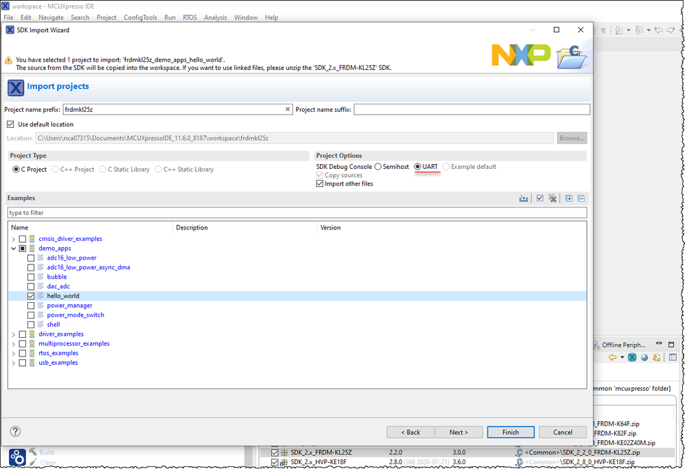

I am using MKL25Z128 MCU. In my software I use PRINTF to send out debugging information. However, I cannot see the information either on console or UART0. Anyone can tell me how to setup it and make the information send out to UART0? Many thanks.

Hi victorheca,
Please download the latest MCUXpresso SDK. The hello_world example printf messages by UART0.
