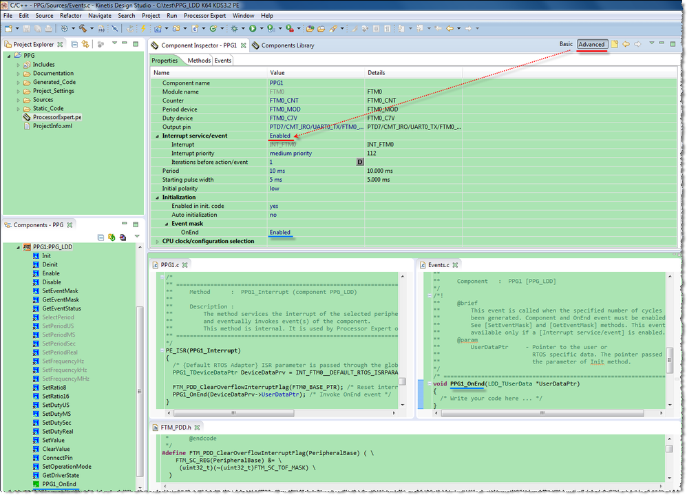

I'm currently using a PPG1 "programmable pulse generation" component to change frequency at run time, and it works.
What i would like to do next is to use the timer overflow interrupt flag that associated to the PPG1 in PEx to manipulate some data. However, i don't think the possibility of using FTM counter overflow in PEx is possible as i don't see the option is visible anywhere in PEx components window.
Is that true ?
1,331 Views
Robin_Shen
If you want to use FTM counter overflow interrupt, you may need to enable the interrupt service/event of PPG_LDD.
Robin
