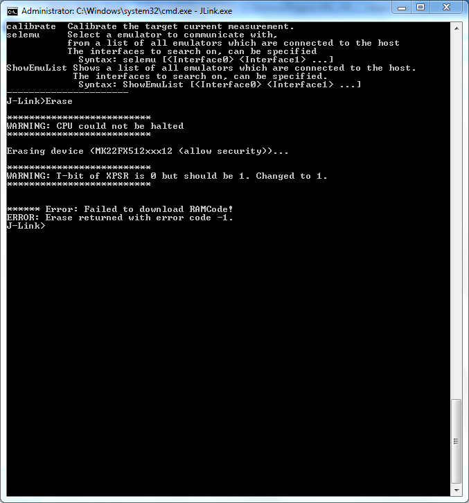

brendanmerna
Kerry,
I got a new board and followed your all your steps. Currently on a windows 7 laptop. I ran the Erase function after connecting and it failed with this error.
Do you know what I did wrong?
4,746 Views

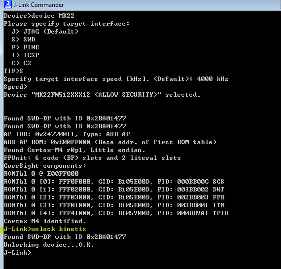

kerryzhou
Hi Brendan Merna,
   Please follow my step and try again:
1. open JLINK COMMAND window, do mass erase at first
Input: unlock kinetis
Do the mass erase at first.
2. Please use my attached .bin file, send it to your :FRDM-K22FJ device.
I have attached the FRDM-K22F_OOBE_1v0.bin file.
After you download it to your FRDM-K22 board, the LED will blinking.
If this bin can work, your problem will be caused by your code, you need to check your own code.
Kerry
