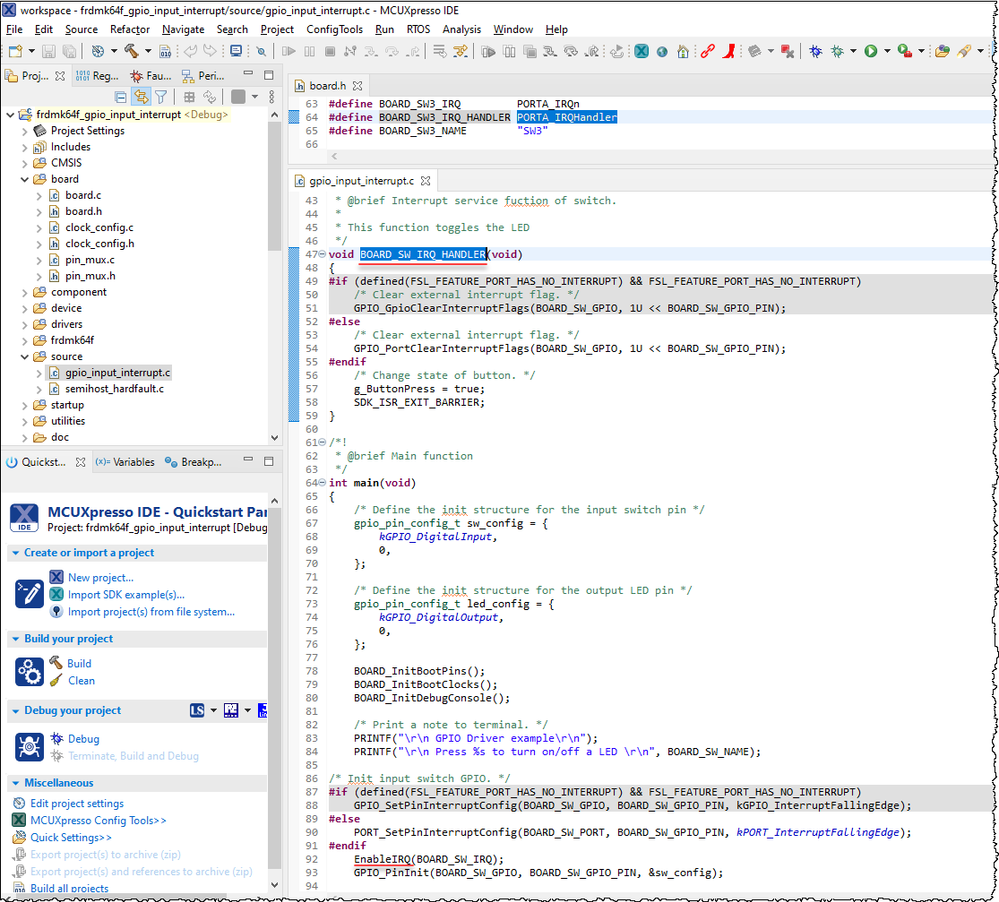

Did you enable the interrupt and Interrupt service function? You can refer the frdmk64f_gpio_input_interrupt SDK example.

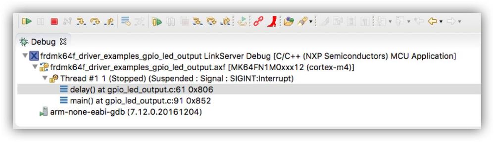

During debug, please check the Figure 11.5. Debug controls and Debug Call Stack
