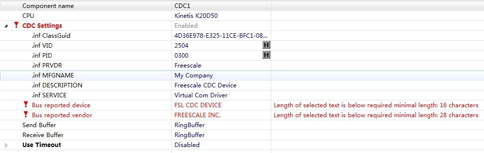

I've got a strange problem using the FSL_USB_Stack component of PEx for my Frdm-k20d50m board.
The problem is that in the sub-component FSL_USB_CDC_Device, it shows,
Do you know why I got this problem? Please help me!
Many thanks!

I assume you are using MCU10.6?
So yes, there is a bug in that Processor Expert.
You have two options:
a) Either enter exactly the number of characters requested, like
FSL HID Keyboard123
FREESCALE INC.12345678901234
or
b) Download and use the the latest version of the components from GitHub (I have implemented a workaround) (mcuoneclipse/PEupd at master · GitHub)
I hope this helps,
Erich

kenansun
Hi Erich,
Thanks for your answer!
Yes I'm using MCU10.6 and your second solution solves this problem.
I also tried to change the two values (like add some characters) but it seems that PEx doesn't accept any modification. I'm not sure if it is another bug.
