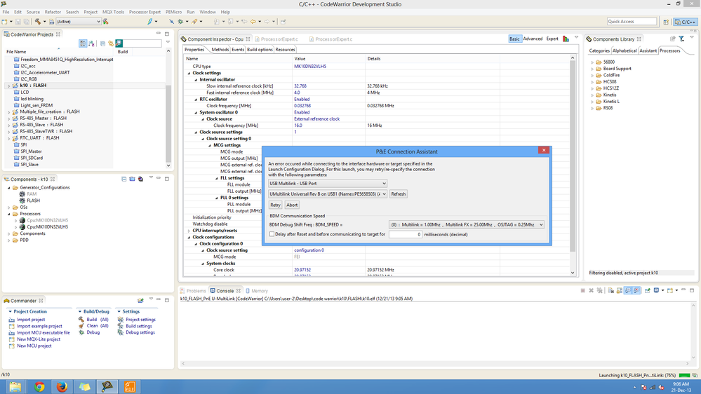

I am trying to connect with k10 uc and programing it using code warrior 10.5 with PE but it is giving following error message
The part no on the k10 uc is M10A5V1N88B4JXOBQ. I tried with 3 different k10 uc with same part no. and selected the MK10DN32VFM5 in LQFN 32-pin package in codewarrior. but it didn't worked, I tested PE Multilink Universal by programming FRDM-KL46Z board by connecting mini headder at SWD connecter it was working for that. But for K10 board it didn't worked. Please look into the matter.

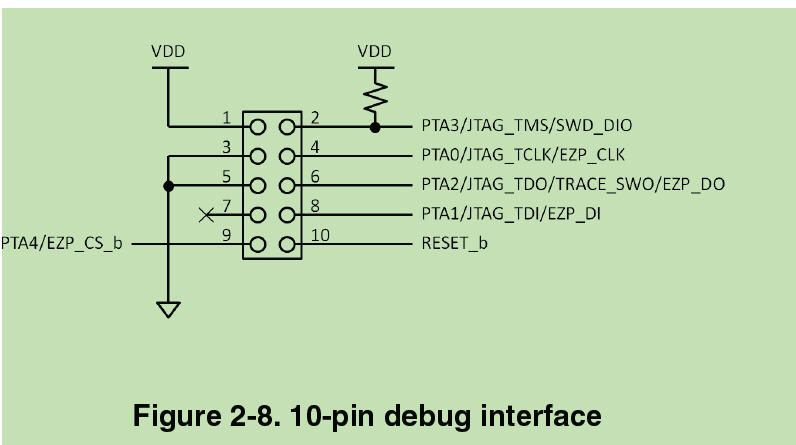

     1, Whether your SWD connector circuit is correct, do you like the following picture?
you can find the details in the chapter 2.1.5.3 debug interface of the manual reference , the download link is :
http://cache.freescale.com/files/32bit/doc/quick_ref_guide/KQRUG.pdf?fpsp=1&WT_TYPE=Quick Reference Guides&WT_VENDOR=FREESCALE&WT_FILE_FORMAT=pdf&WT_ASSET=Documentation
2, Check the circuit of pin RESET_B, please refer to 2.1.3.4.1 RESET_b and NMI_b of the manual reference, add pullup and capacitors.
3, Test the wave of EZP_CS_b and REST_b, whether it can be high?
4, Then, please setup you driver of multilink universal again.
For this problem is not caused by the external oscillator,  when power on, the clock is in FEI modet, so please do the up items at first.
Wish it helps you! Thank you!
