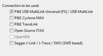

When use the CW to program the target, it also need to choose the exactul connection(Fig 1), however as I mentioned in last reply, CW doesn't support Ulink2, you can try Keil+Ulink2 to debug or program the MCU.

                                                                      Fig 1

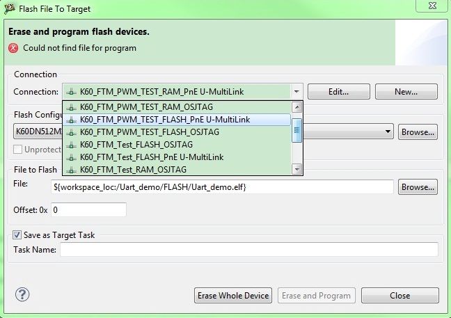

I'm afraid that CW don't support Ulink 2. When I create a project by CW, you will see the Ulink2 is not involveed in the list of support debug tools.
I've attached the screenshot and you can check it.Wish hope.

Yes. I think i should change to Seger J-Link. Codewarrior support this. Thank you
