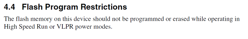

I'm working in Run mode and MK66FN2M0VMD18 features only  2MB program flash memory bank.
I need to store program code in the first half and data for update purposes in the second half. What I need to do is:
1. erase second half and write update data
2. erase first half and copy data from the second half.
Do I need to use program memory swap mode? Why running Interrupts may cause an error when accessing the flash bank?

I'm using Kinetis MK66FN2M0VMD18 on a Custom Board and I'm facing the same troubles when I'm attempt to write or erase flash memory.
I cannot disable interrupt when I'm operating on flash because of the behavior of my application.
I'm not sure that disabling interrupt will resolve my problems but  at the same time I don't have any other valid solutions.
Could You explain me why disabling intterupts when executing flash commands should be the solution to this issue?
Is there any official document by NXP asserting this solution?

mjbcswitzerland
Specialist V
There are multiple flash banks in the K66 and as long as your code is not running (and no interrupts need to run) in the Flash bank being erased/written there is no difficulty.
