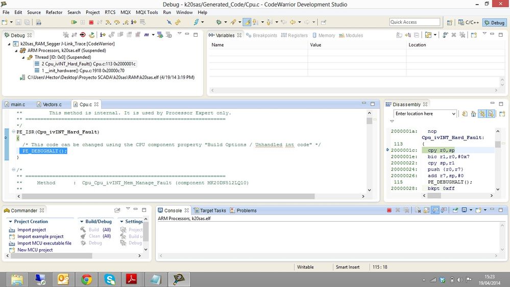

I am trying to make work a Kinetis K20DX128, but when PE start there is a problem:
And there it stays, like a loop.

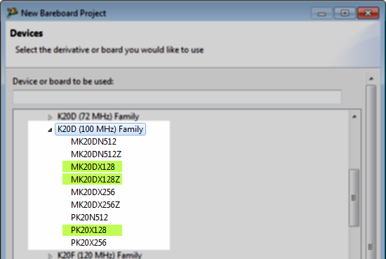

Hello Hector:
This could be a problem with the silicon mask revision. Is this a project created by you or an example project by Freescale?
When creating a project for the K20X128 (100 MHz as I see in your picture), you have three options:
     - PK20X128 and MK20DX128Z correspond to silicon Rev 1.x.
     - MK20DX128 is for silicon Rev 2.x.
You need to check the label on the top of your MCU, refer to AN4445 for full details and select the proper device accordingly.
I hope this is helpful!

HIMU
Dear Jorge.
Thanks a lot for your help, it would have blown my mind.
Sincerely.
