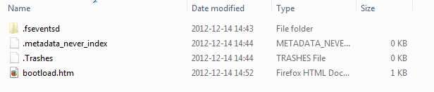

DavidS
Hi Peter,
What is the revision of your board labeled on back side?
Can you take image of contents of BOOTLOADER folder?
David

paulb-sct
I wanted to add that I just went through this procedure but the debug session still failed. The final problem was due to 'zombie' processes still left over from my initial debug attempt - this is described quite well in Erich Styger's tutorial in
https://community.freescale.com/docs/DOC-101845
(see the Troubleshooting area).
As a suggestion, the driver David provided in the earlier port here:
DEBUG-FRDM-K64F_Pemicro_v108a_for_OpenSDA_v2.0.bin
should be more widely available than just as a response in these forums.
In case it's still useful, the board is labelled as 700-28036 Rev A and SCH-28036 Rev D. I just purchased it from Mouser last week.
The BOOTLOADER image shows up as:
Paul
