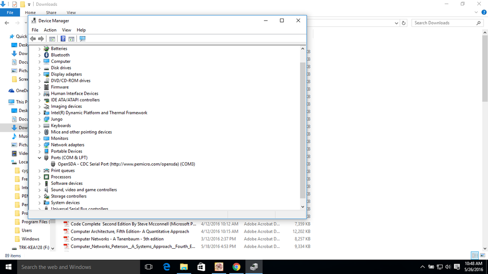

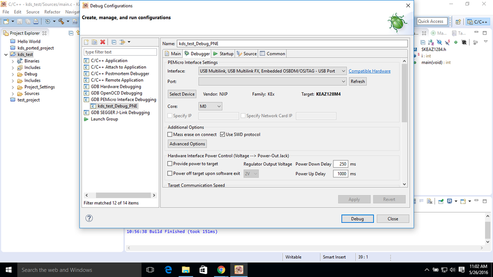

    I created a new project with KDS 3.2 with KEA-128. I tried to Flash it using Open-SDA and it throwed me an error in Service Launch Sequence?
I have attached the Screenshot of it.
This project is a KSDK 1.x project selected as none for KSDK.

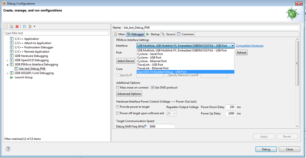

As you have OpenSDA enumerated in your device manager, in the debugger tab of your debug configuration,  you have to select OpenSDA interface.
You should be able to see your port device and debug your project
Please tell me if you have any question.

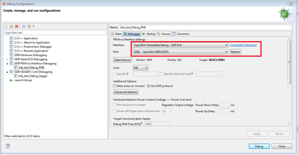

jorge_a_vazquez
Hi VIGNESH BALAJI
I tried your project test, it give me not error. Could you please confirm that your debugger identify your serial port? It should be displayed something like this:
If the port sections appears empty, there could be a interface problem. Please also check this post: https://mcuoneclipse.com/2016/03/11/solving-launching-configuring-gdb-aborting-configuring-gdb/  where they discussed about some wrong line endings in the ‘Commands’ section.
