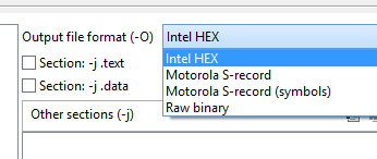

This may be a newbie-level question so I apologize for putting it out there in advance.
I have been working on a simple application using my new FRDM-K22F module.  I would like to make this a standalone application which incorporates the FRDM-K22F module that would be connected to a second I/O board.  As I've used the IDE it is clear that it is only intended for development and not for actual usage, and I have not come across anything within it that suggests that it can create a standalone application.
How would a developer go about doing that?  Can the IDE create SREC's that can be flashed into the boards resident flash?  I've looked around on the web and I cannot find anything that suggests there is a standalone role for the FRDM modules?  Is the .elf file what executes, and if so, how do you link it and fix it into memory to start when you power on the board.  Am I missing something here?

The FRDM boards (with OpenSDA) are very suitable for standalone applications since you can load binary files to them using the OpenSDA's USB-MSD loader, which appears as a hard drive.
There are many projects where the FRDM boards are used together with a shield to become a complete product.
See µTasker Kinetis FRDM-K22F support
The IDEs can generate binary, hex, srec etc.(some support many formats and others only one or two). If you use KDS it can select one of serveral outputs but you can also add a post-buid step that calls a bat file to use GCC objcopy to generate whatever alternative format you may require.
eg.
arm-none-eabi-objcopy  --output-target=binary myProject.elf myProject.bin
[alternatives --output-target=srec, --output-target=ihex etc.]
KDS:
