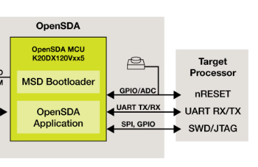

How can I use SPI/GPIO on openSDA application?What is the connections between SPI,GPIO and SWD?
4,339 Views
jingpan
It seems that after you download bootloader, you cant use SWD to debug your own application. You can debug your code when you set address at 0x0.
SPI/GPIO are used by K20 to generate SWD/JTAG signal. You cant use them.

ilginsarican
Hi again,
I want to know that,after downloading bootloader to k20dx128vfm5, can I program target mcu by using SWD/JTAG ?

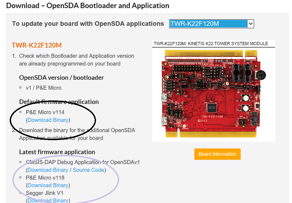

jingpan
Yes, you must use k20dx128vfm5 as the debugger. Your final target is MK60. It is meaningless to download openSDA source code and migrate to other MCU.
As to the firmware, you can use TWR-K22F120M. In the attachment picture, the black circle slect the bootloader. You should use a jlink/ulink or some other debug tools to download the bootloader to firmware. Afer that, you can connect k20 usb port. If the work is success, you can see a new disk appear in your computer system. The purple circle choose the application which works base on bootloader. Select one and drag and drop it to the new disk. Then your debugger is ready. Details can also be found in <Getting Started with MCUXpresso SDK.pdf> which can be found in SDK package.opensda_download.png
