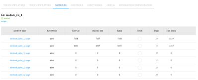

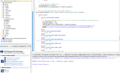

I compiled the project an deployed it, and it works fine, when I press Electrode-1 and 2, I can see change in LED color.

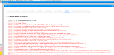

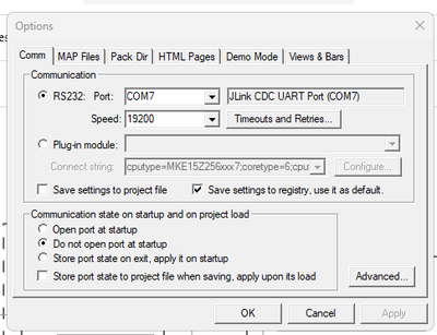

The problem is how to visualize the signals with FreeMASTER, I used the below mentioned setting i.e. using J-Link Plug-In module.
and after reading the board configuration I am getting the following logs.
but instead of using J-Link, I if I use USB to Serial Port of this development board, it works fine.
The reason why I am asking is because, the actual electronics which we have is without any free UART port to be associated with FreeMASTER, the only thing which we can utilize to do tuning and visualize the touch signal is JLink, and with JLink, I can't make the default example work on the Freedom board and that's why I can't make my actual project working.
