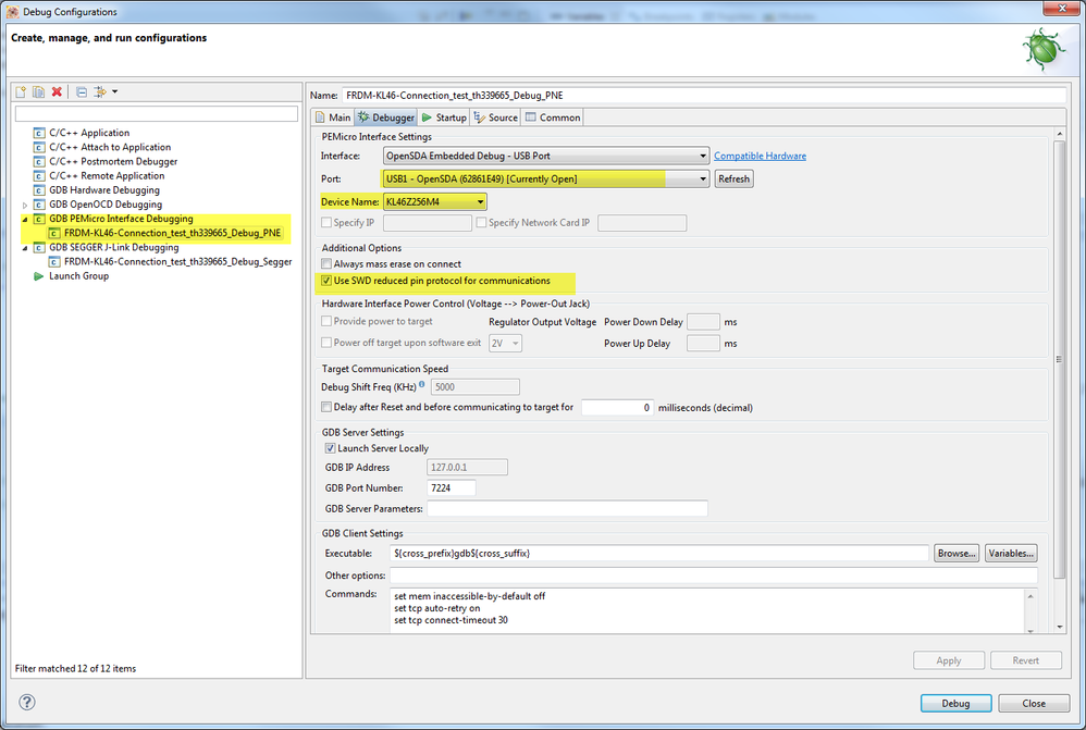

Here you can see my debug configurations:
Check the highlighted parameters on your configuration.
It is possible that you Antivirus is handling the device or the device's driver like a threat for the system, try to disable for a while this and reinstall the drivers. Also you can try to debug with the antivirus disabled.
Hope this information can help you

kenholt
Hi Adrian -
Thanks for your settings.
My settings on the driver are the same as yours.
On the debug config, mine are the same except for the blank port window.
Also, on the bottom, I have a check box labelled "Force thread list update
on suspend" . I suppose I have a slightly different version.
After I deleted McAfee, I now get "Windows firewall has blocked some
features" as soon as click on the Debugger tab.
Firewall did let me have access, but maybe I should try to turn off or
delete the firewall.
There must be a log somewhere that tells the interface setup between KDS
and Windows. 7 home premium probably has something unusual.
Ken
