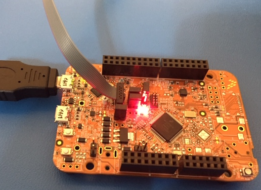

I took some time here to try and explain to others what is really going on and what I learned. It is on the web but scattered through many documents. It all stems from the fact that there are two USB ports on the Freedom Dev Kit and two processors. The K20 and the K22.

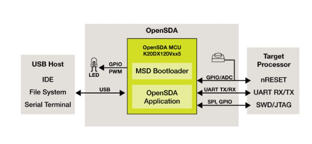

One is for the OpenSDA (K20) debugging interface processor and the other for our target (K22) processor. Both processors can run a bootloader and an application.
As you can see in this image, there are two USB ports on the Freedom Dev kit. The one connected in the picture is for the OpenSDA (K20 processor). The other one is for us (K22 processor). This is very important because both ports can show up in Windows as a USB memory interface with different names. Note: In this picture, I also connected the Segger EDU Mini debugger to unbrick my K20 OpenSDA processor. (another thread on this forum)
Let's quickly start with the K20 OpenSDA processor. It is running a bootloader and an application. If you hold SW1 / Reset button down while plugging in the OpenSDA USB port, the K20 will boot up in its bootloader mode. Depending on the version of the bootloader, it will look in windows like BOOTLOADER (OpenSDA v2.1) or DAPLINKBOOT (OpenSDA v2.2).
Now, if you don't hold the SW1 / Reset button down while plugging in the OpenSDA USB port, the K20 will boot its OpenSDA Application (You can find various ones on the web from mbed, segger, etc.). These applications are what makes debugging nice and easy from MCUXPresso. I used the file "01_OpenSDA_FRDM-K22F.bin" and it allows the K20 to show up in windows like E:/FRDM-K22J with the following files on it.
