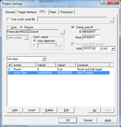

If your NMI is LOW ([edit] assuming NMI is gorunded due to HW) at REST you can try programming devices by first clearing the NMIE bit in SIM_SOPT (0x40048004 for MKE02).
When using J-Link this can be easily done as an Init Step: Write 32bit    40048004   00000008

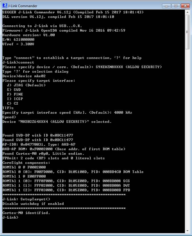

  1. You can use the JLINK debugger, and open the JLINK commander window
   To check, whether you can find the ARM Cortex m0+ core, if you can't find the core after connect it, you need to check your hardware, especially your SWD interface.
  Before you are using the JLINK, you need to install the JLINk driver at first, download the jlink driver from this link and install it:
SEGGER - The Embedded Experts - Downloads
 After you install it, please open the JLINK commander window, and connect your KE board, this is the picture from my side.
You can find the cortex m0 core is identified.
This means I can use the JLINK to download the code.

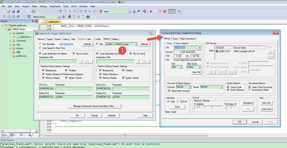

2. Use MDK to download the code with JLINK
  You must configure the debugger as JLINK at first.
After configure the options, then you can download it.
Please follow my way and try again.
