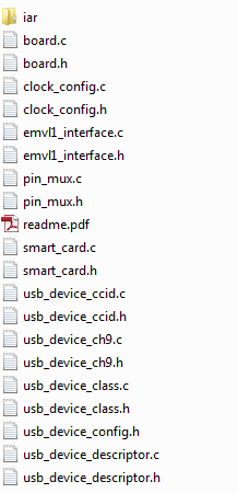

cutworth
Hi Mohammad,
The USB CCID demo code is already included in K64 USB CCID demo. You can find the following files for that demo. usb_device_ccid.c and usb_device_ccid.h implements the main logic for CCID class.

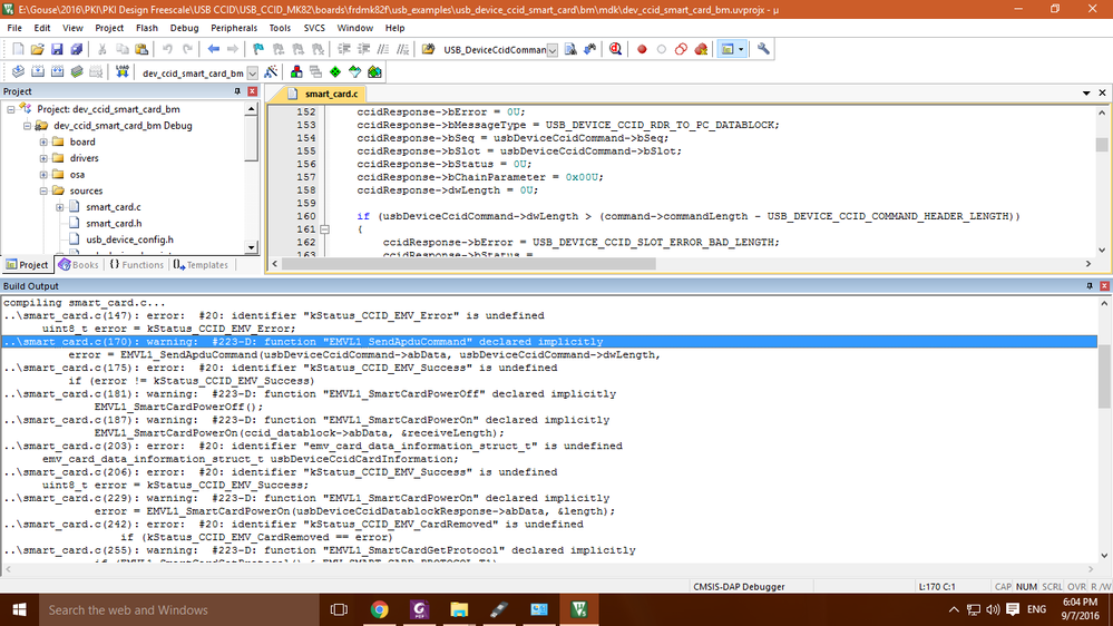

gouse_saudi
Hi Cutworth,
   I tried to implement this CCID demo code with K82, but i am getting the following errors
6,455 Views
cutworth
Hi Mohammad,
The EMVL1_SendApduCommand function is inside emvl1_interface.c file which is also included in the K64 USB CCID package. That function will also call emvl1 core code so most probably you will need to add those files in your project too.
As you do not talk to smart card in this case, I suppose you may still need to change some of the code to make it work on your side.

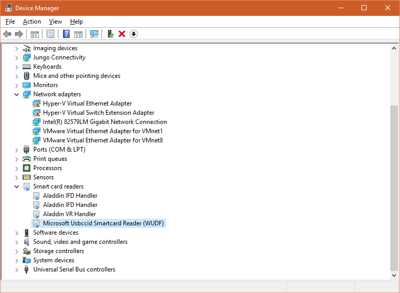

gouse_saudi
Hi Cutworth Wang,
    Thanks for your response, I comment the code lines related to emvl, then it works. Kinetis k82 is recognized as microsoft usbccid smartcard reader(WUDF).
Thaks once again.
