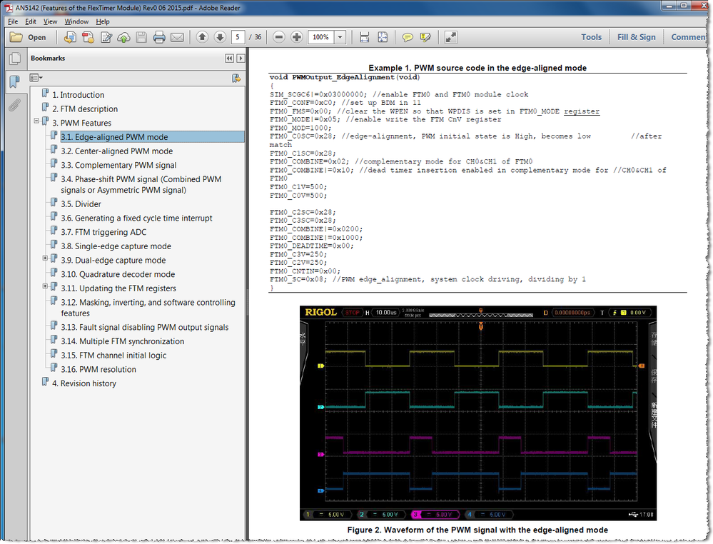

Hi All,
I am using Kinetis K26-180M, I am new for embedded system and i need to generate multiple frequency's tone using PWM,
In my hardware the speaker lines are with FTM1 and FTM2 modules, could you please give any sample code for pwm genration on FTM module. also i am using IAR embedded work bench.
Thanks and Regards,
sujin
5,205 Views
Robin_Shen
Maybe you can refer the example in "AN5142 Features of the FlexTimer Module".
Robin

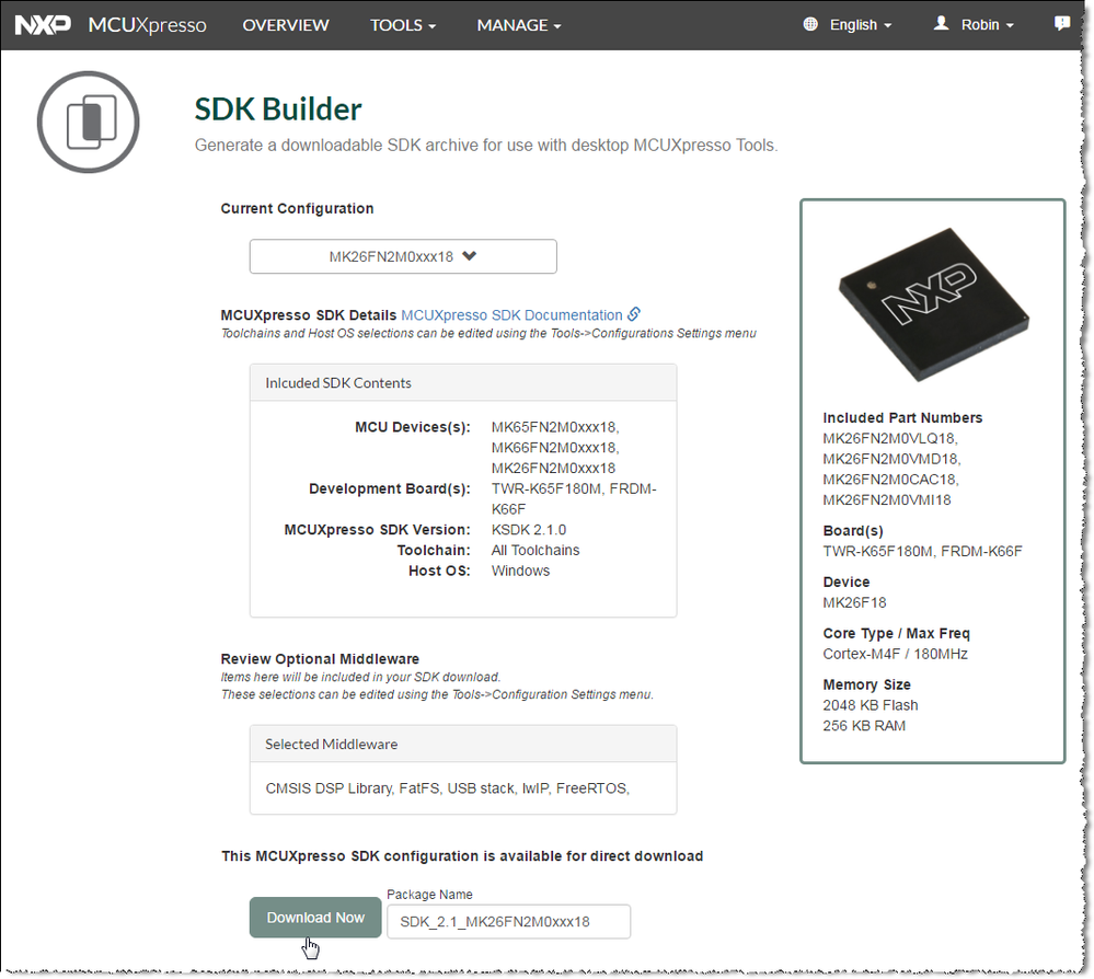

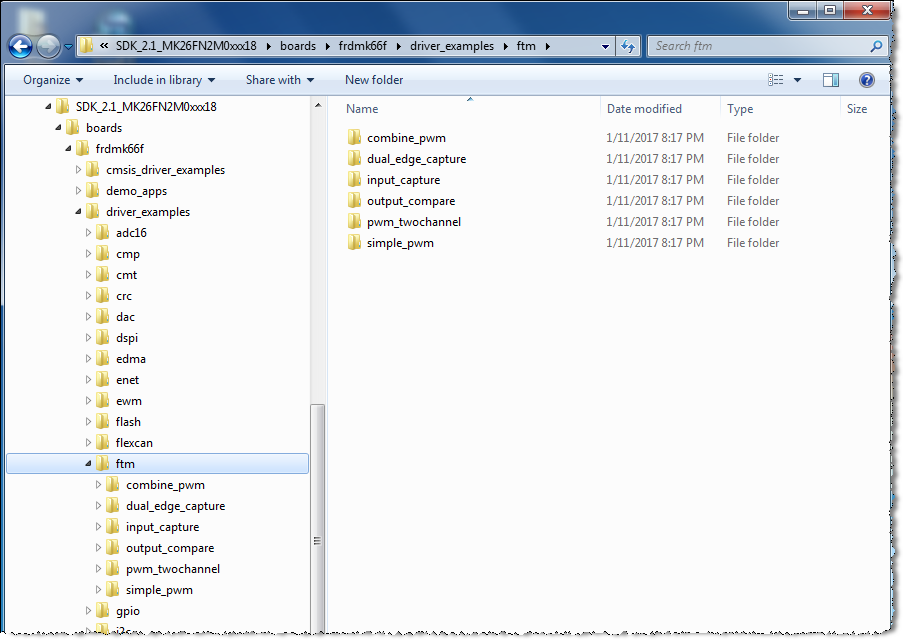

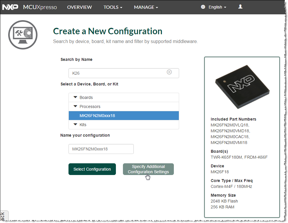

Hi Sujin,
You can refer the PWM examples in KINETIS-SDK.
Please search K26 then select MK26FN2M0xxx18 and download SDK_2.1_MK26FN2M0xxx18.
You can getting start with KSDK reading "How to start with KSDK".
Robin

sujinvincent
Hi Robin
thanks for you time
I got those examples, I gone through it, I feel too hard to digest those configurations and coding, Bcoz I am entirely new for embedded system, so if there is any code for accessing from register level it will more helpful to me
my situation is like i need to create bare metal example in which configure the clock as external 16 MHZ oscillator, from that oscillator i need to clock the timer module.

Robin_Shen
Robin
