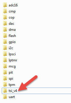

jeremyzhou
Hi Bhavin Maru,
As I mentioned before, the KSDK has included the TSI demo which reside in ~\boards\frdmkl25z\driver_examples (see Fig 1).
And you can build the KSDK for the FRDM-KL25 board through the How to: install KSDK 2.0 .
Hope this is clear.
Ping
