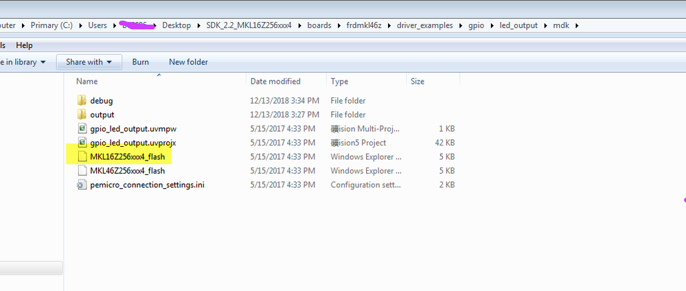

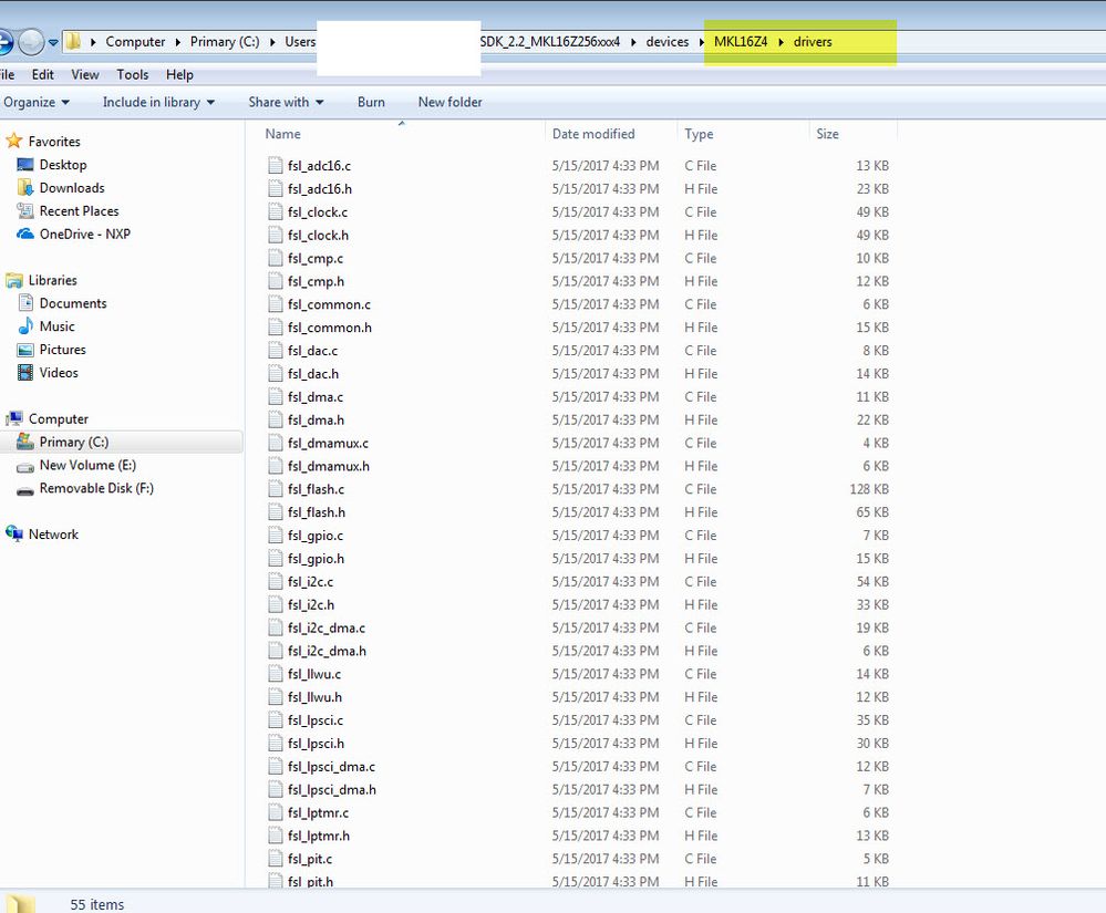

  After you download the official SDK sample code, you can find the MKL16 driver in this folder:
You also can modify the official SDK project, take this project as an example:
SDK_2.2_MKL16Z256xxx4\boards\frdmkl46z\driver_examples\gpio\led_output\mdk

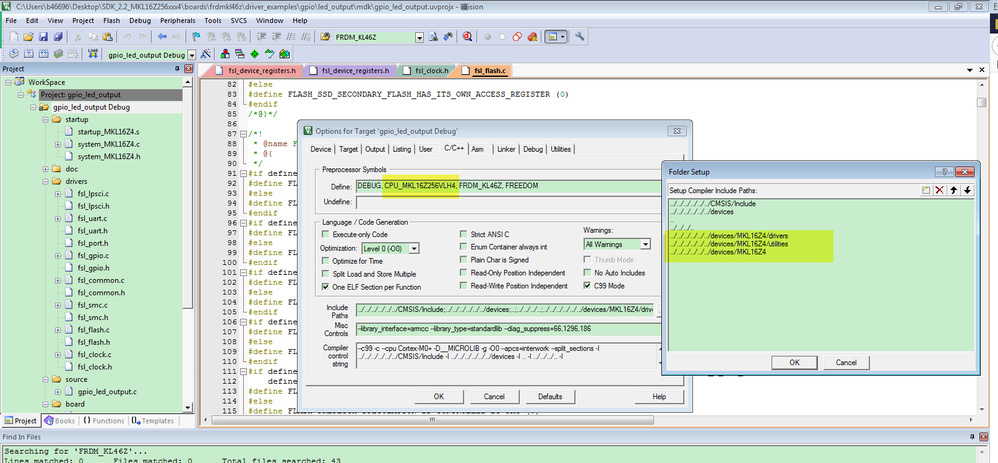

The default example is based on MKL46, so when you open it, you need to change all the MKL46 code to the MKL16 code and driver in folder:
SDK_2.2_MKL16Z256xxx4\devices\MKL16Z4
1. startup_MKL16Z4.s in folder SDK_2.2_MKL16Z256xxx4\devices\MKL16Z4\arm
2. system_MKL16Z4.c and system_MKL16Z4.h in folder SDK_2.2_MKL16Z256xxx4\devices\MKL16Z4
3. project driver should be replaced by the drivers in folder: SDK_2.2_MKL16Z256xxx4\devices\MKL16Z4\drivers
4.  modify the options
5, copy MKL16Z256xxx4_flash file from folder  SDK_2.2_MKL16Z256xxx4\devices\MKL16Z4\arm to SDK_2.2_MKL16Z256xxx4\boards\frdmkl46z\driver_examples\gpio\led_output\mdk

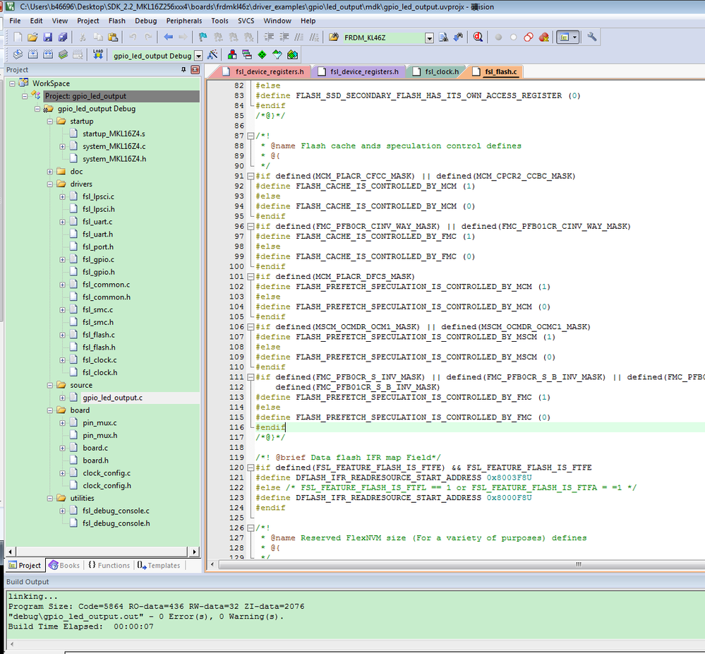

Then build the project, you can find there no errors.
This is the MKL16 project, I also attach my modified project for your reference.
Wish it helps you!
