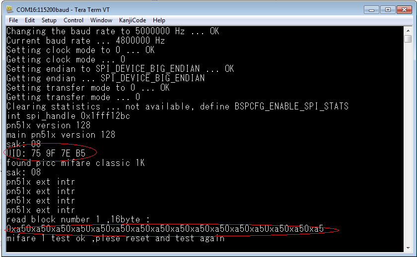

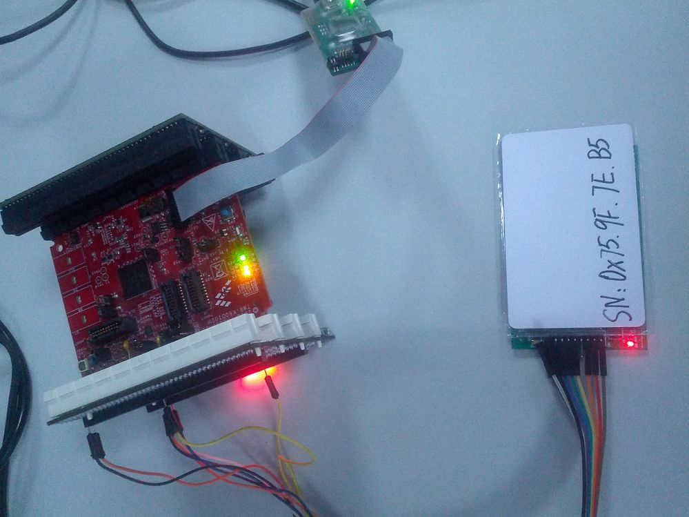

           This is a demo of NFC device to read and write the contactless card.
Kinets K60 tower board and NXP PN512 board are used for this test enviroment.
These connected pins from K60 tower board to PN512 RF board are listed as below:
  SPI1:
    SPI1_SIN : PTE1/SDHC0_D0
    SPI1_SCK : PTE2/SDHC0_DCLK
    SPI1_SOUT : PTE3/SDHC0_CMD
    SPI1_PCS0 : PTE4/SDHC0_D3
  Reset:
    PTB9
  External interrupt:
    PTA26

  The following diagram shows the serial numbers and block data of reading from the test card of Mifare one.
