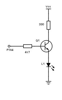

Hi kareem,
The PTA4 by default is a NMI function. Driving the NMI signal low forces a non-maskable interrupt, if the NMI function is selected on the corresponding pin.
If it is possible, please use another pin instead of using PTA4 as GPIO.
If you want use PTA4 as GPIO function, please refer below:
  Using the NMI_b pin as GPIO on KL15 device
  Disable NMI_b pin/interrupt KL04Z?
  Need to use pin PTA4 but not as NMI_b (KL15)
Robin

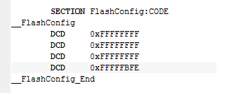

Thanks Robin,
I found the problem and found that I can disable the NMI using flash config, I've changed the flash config in the startup code to disable the NMI but nothing changed in the flash.

ahmedwahdan
I attached a picture of what connected to PTA4 and when switched the connection to another pin  it worked fine!!!
I've notied that PTA by default is a NMI so now i'm working on changing the default values and i'll keep you updated

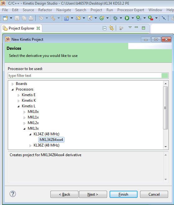

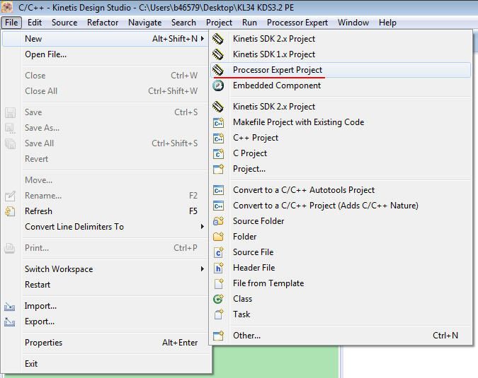

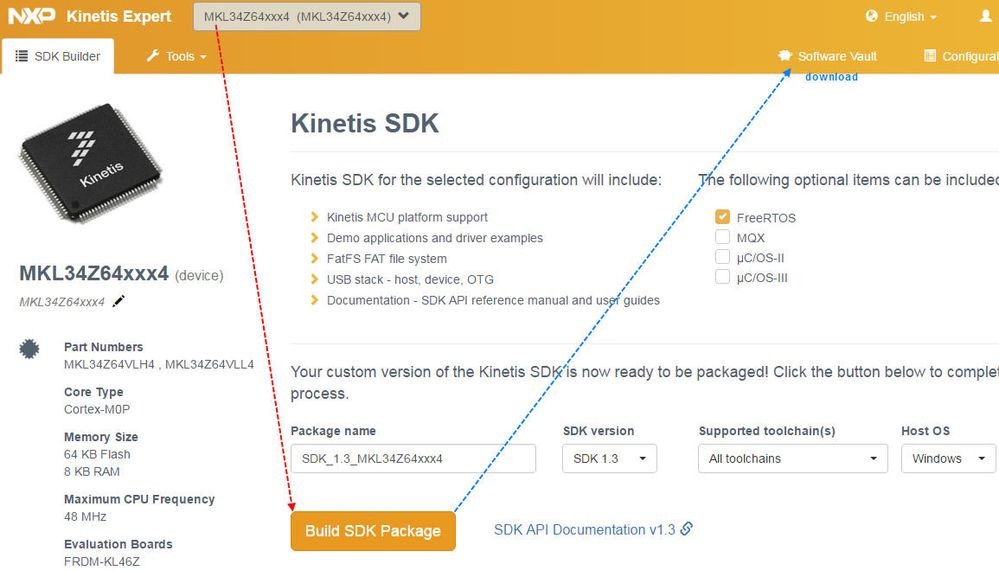

Robin_Shen
Hi kareem,
Have you test the project in SDK_1.3_MKL34Z64xxx4?
You can also test the Processor Expert project created by KDS3.2.0.
If the project still have problem on your customer board, please attach the schematic of your board.
What debugger are you using, Segger J-Link or PEmicro or the others?
Robin
