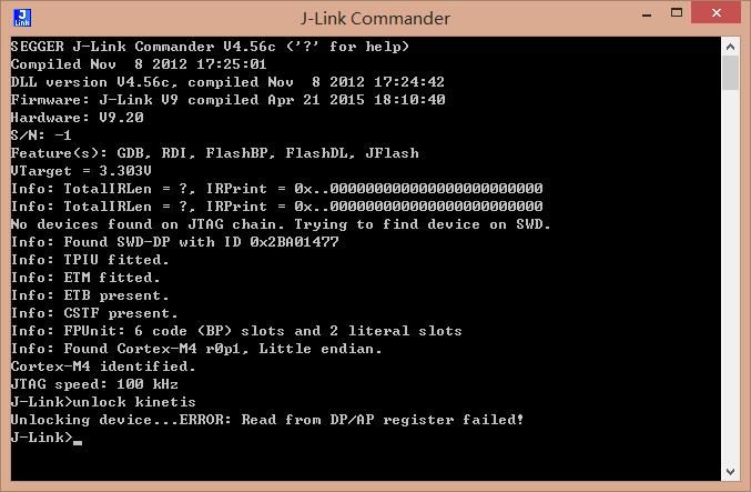

Once I set frdm-k64f IO PTA0 and PA1 as Ftm, when find it working wrong I reload codes by CMSIS-DAP.
But it give me thisQQ截图20160206134831.jpg.
I have tried use Jlink,but it doesn't work as well.
And i have try some ways to reflsh k64.
unfortunately,I think i make it worse and worse.
what can i do to save my frdm-k64f?

Carlos_Mendoza
Hi Zhu,
Have you tried using the P&E recovery utility? Take a look to the following post created by our colleague Erich Styger, it explains how to use it to recover your boards:
Bricking and Recovering FRDM-KL25Z Boards: Reset, SWD Clock and Low Power | MCU on Eclipse
Please notice that you will need an external probe like a Multilink.
Hope it helps!

zhuhuaitao
thanks for your help.
I have solved this problem by this card:
Kinetis Lock原因的调研及解决方案
thanks again.
