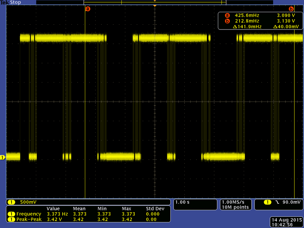

Further investigation : Interrupt priority fix just masks the issue. Found a problem writing to two different files, every few seconds a write takes an entire second. The scope grab shows quick writes followed by long delays of a second.
Any ideas?
Test code:
* SD Card writes will periodically take 1 seconds when writing to two files

8,381件の閲覧回数

I think that you need to clearly seperate pre-emptive threading, the FAT and the SD card's own behaviour to be able to work out exactly what is happening.
SD cards do get quite slow sometimes (although I would not expect such repetitive slowness but rather something more random as to when it happens and how long it is busy for). It is also a good idea to use an industrial grade SD card since it is even possible to "break" some cards when writing continuous high speed data in small chunks (eg. the card will suddently never allow writing again although it can still be read normally - and doesn't signal any errors or protection in its status register - also a PC will "think" that it is writing to it but the new data will not be stored. The advice from SanDisk was to use an OEM type instead).
I have a (K64 based) product in continuous operation for 6 months or so logging two ADC data streams at each 40kBytes per second - filling up a 16G card each 2 days or so. Randomly the card will slow for a short time (this is because it is doing its own internal clean-up operations and signalling that it is busy, thus blocking the K64 from actually writing anything until it signals that it can accept data again). This uses the uTasker OS and utFAT - a bit of buffer tweaking to hold data input data while the card randomly signals busy was needed to avoid dropping input data.
Better performance can be obtained using SD card block writes (rather than the sector writes that your FAT will probably use) but it complicates the FAT, especially when multiple sources are writing, and can only be used in SPI mode on the K64 due to the problem that its SDIO controller doesn't support suspending transfers in progress (needed when multiple sources can access the card in an interleaved fashion).
When using pre-emptive operation make sure that the tasks use some form of protection so that one task performing an operation is never pre-empted by another one that wants to access the card (also when it is waiting for a card to signal that it is not busy again) - if the FAT doesn't include such protection itself it will probably quickly fail when there are multiple write/read sources..
What sort of (continuous) storage rate are you trying to achieve?

Unfortunately I don't expect that you will achieve more than about 50..100kByte or so "continuous" with FatFS (although there may be some configuration options that may improve it a bit - like enabling data caching and reducing the amount of data object and FAT writes [tradeoff between reliability and potential loss of data]).
To get that rate I think that you will also need to write much larger blocks (make much larger single writes - preferably in the hundreds of kByte range each time).

The same arrangement shown in the test program works (much smaller and less frequency delays, if any) when just writing to the single output file. I recorded an average of 250 of these 5120 block writes per second or roughly 1.3 MB/s.
How large would you expect the drop of performance caused by adding additional output files to be?

Sam, Your 1.3MB/s sustained is achievable. We've been able to get well over 9MByte/s sustained streamed data onto a class 10 industrial rated card using a 150Mhz K60. It will take some optimization. The quality of the card will affect throughput.
We are using FATfs. We did have to optimize the block writes to achieve the throughput. We try to restrict our writes to 512 bytes at a time. We only have one file open when we're streaming. While our homegrown OS is multitasking, it is not preemptive. Our SDHC card driver is interrupt driven.
When the card is pushed this hard, the times the card becomes non responsive have a fairly consistent repeat and duration.  The rate they happen and the length do differ from manufacturer to manufacturer and card lot to card lot. You will need a large enough buffer to handle the non-responsive times. They can be > 500mS. Smaller block writes cause the non-responsiveness to happen more often.

3. It is true that SD cards sometimes block for up to, and some times longer than, 500ms. For standard' industrial grade cards it seems to repeat every 5s or so, which reduces the storage rate by maybe 10% overall. But to bridge 10Meg Bytes data for 500ms you need to store 5Meg of data. Where do your store this (in SRAM?). With the K64 (256k internal RAM) I needed to use half of it to ensure no ADC loss at around 80kBytes/s.

We are using block mode not sector mode. We transfer 512 bytes at a time.
We don't continually update the FAT table as we write. We pre-allocate the room we need for the data in the fat table. We ask for large empty blocks from the FAT table. We can then stream the data into the empty pre-allocated space. When the empty space is filled we go back to the FAT and request more. We trim the file's size after the acquisition stops. We know how much data is in the space by having repetitive block markers stored in the data stream. This greatly reduces the number of FAT table  accesses.
Our products are vehicle engineering development tools. We bury our modules into our customers vehicles. We don't have control over the power. We could lose it at any time. Updating the FAT table as we write the data could leave us with an unusable file, when the power goes away. It means we have to update the FAT table before we collect the data. As a side effect it helped with the speed. We allocate large blocks on the file system.
We also believe that by pre-allocating the same sized block all the time helps limit the amount of time the SDHC card reports itself busy. We believe most of the time the card is busy it is trying to find un-erased flash blocks. By making the FAT allocation requests repetitive and consistent seemed to make the card availability more deterministic.
While we are interrupt driven, We're using the DMA to transfer the 512 bytes. So one interrupt for every 512 bytes. We only need to update the DMA table with pointers to the collected data  in the interrupt.
You are correct about the data buffering for the long not available times. We found by pre-allocating, and playing with internal buffers sizes we had enough internal RAM on a K60 to meet our 3MB/s requirement.

Pre-priming the FAT and then writing into essentially linear space allows large block writes and thus the maximum card write speed to be achieved.
As I undersand it, you modified some parts of FatFs and trade off general file system operation to achieve max speed (and /or other requirements) for a dedicated single file.
In this case I agree that in the region of 10 Meg Bytes is achievable (this is easy to test by writing large amounts of data to the SD card in raw mode, which suits the block command very well).
Therefore I think the conclusion is that the maximum achievable FAT operation depends on various factors, whereby
- standard out-of-the-box FAT with multiple parallel file reads/writes can be fairly slow
- customised operation (emulating linear raw mode writing) and resticting FAT functionality can be quite fast
For requirements in the middle, some FAT customisation and some restrictions in FAT operation may achieve a compromise between the two. Some custom development may be required in the process.
Returning to the original topic - the (sometimes long) card busy periods are in fact well known and to be expected. Avoiding certain types of operation can reduce their frequency. Whether target data rates can be achieved will be somewhat application specific and some custom development may need to be foreseen in some cases. In pre-emptive multitasking environments with multiple parallel operations care needs to be taken to avoid operations conflicting with each other - it seems a good idea to be sure that this aspect and the card performance itself are strictly separated during analysis to be sure of accurate results.
