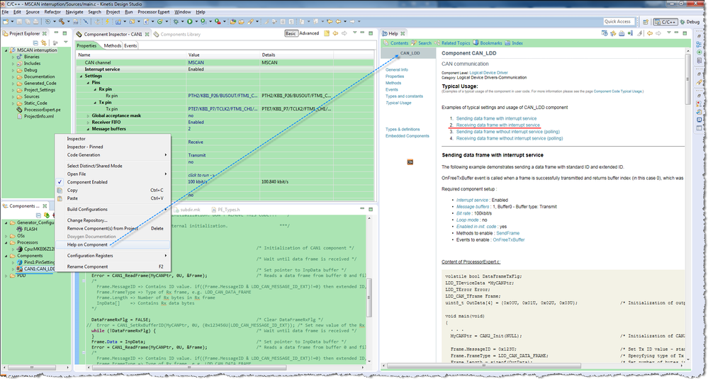

I'm doing the sample project for MSCAN on the KE06 with the Expert Processor and it just does not work!
The interruption that rises the flag never arrives!
Anyone have experience with this?
1 返信
1,599件の閲覧回数
Robin_Shen
Hi CARLOS,

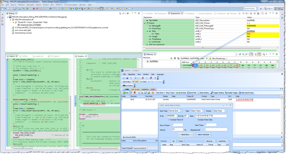

Have you try to test the Typical Usage '2.Receiving data frame with interrupt service' of CAN_LDD?
After send the data from CAN-bus tool on PC, you can find it will run into 'CAN1_OnFullRxBuffer' event.
Test it with FRDM-KE06Z board and the other node is USBCAN tool. The IDE was KDS3.2 with Processor Expert.
