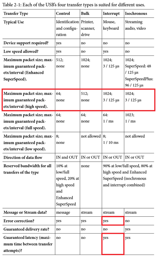

nbgatgi
Mark,
I believe you are incorrect regarding max packet size for USB high-speed (HS) interrupt transfers.  512-bytes is the high-speed limit for bulk transfers, but it is 1024-bytes for interrupt transfers which are used by HID.  We chose an interrupt transfer class over bulk because it provides guaranteed latency (maximum time between transfer attempts) and bulk transfers do not.
For reference, here is table 2-1 in Jan Axelson's "USB Complete: The Developer's Guide" 5th Edition:
I have been able to validate that the packet transmission time for a HS port is the same up to and including 1024B.  Note that per the USB specification, up to 3x 1024B burst-packets can be sent within the 125µs polling period.  That is of particular note since that means that the maximum data-rate for interrupt transfers using a USB 2.0 high-speed port is the same as a USB 3.1 port!
What you are proposing is effectively what we are doing.  Starting with the generic HID example for the MCUXpresso SDK, I have modified the report descriptor for 32-bit reports.  We do not foresee a need for 64-bit information so 32-bit reports double the number of reports within a 1024-byte packet.  Furthermore, as I've discovered in researching this, for a generic or vendor defined "usage page", the information in the report descriptor is only relevant if you make it so on the host application side.  Otherwise, the received data can be cast to whatever data structure you want assuming you are controlling the applications for the device and host, which is what we are doing.  Of course if you are trying to communicate the structure to an unknown host application, the report descriptor becomes very relevant.
Nick

mjbcswitzerland
Specialist V
Nick
I referenced bulk (512/64) and isochronous (1024/1023) and not interrupt, which is as stated in your table (1024/64).
I had forgotten that interrupt endpoints are used rather than bulk...
Mark
