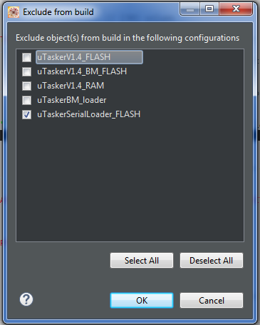

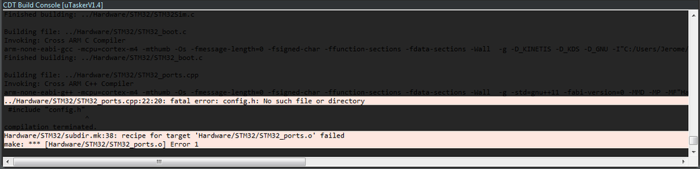

F50SC
Hi Mark
Thanks so much for your reply and recommendation on uTasker.
I'm following your video on how to build in KDS here uTasker SHORT Getting Started - From GIT to KDS build - YouTube , but I'm getting an error
to do with STM32_ports.cpp file, No such file or directory when locating config.h.
This doesn't seem correct to compile STM source files as part of the build for Kinetis.
Any ideas, another configuration somewhere in the project settings or in the config file?
UPDATE SOLVED! I excluded STM folder from the project build.

mjbcswitzerland
Specialist V
Jerome
It is correct to exclude the STM32 directory - that is a bit of nuisance with KDS (and co.) because if one adds new files to the framwork every project sharing the framework then includes them as default. Although I updated the KDS projects I may have missed excluding something but, as you have seen, it is simple to fix: I'll update the KDS project asap.

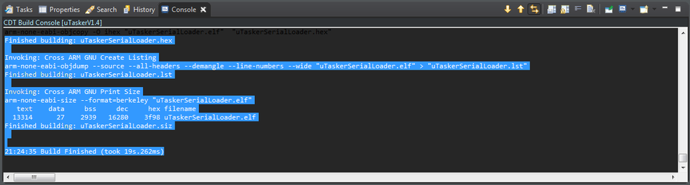

F50SC
Hi Mark
I've hit a bit of snag, it seems the MCU clock is not setup correctly for my target and is not getting past the below line (kinetis.c) in the debugger...

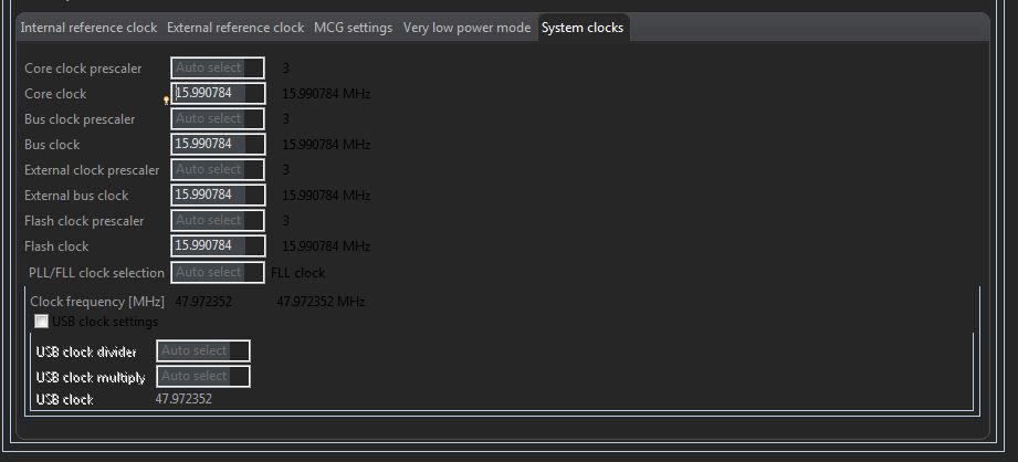

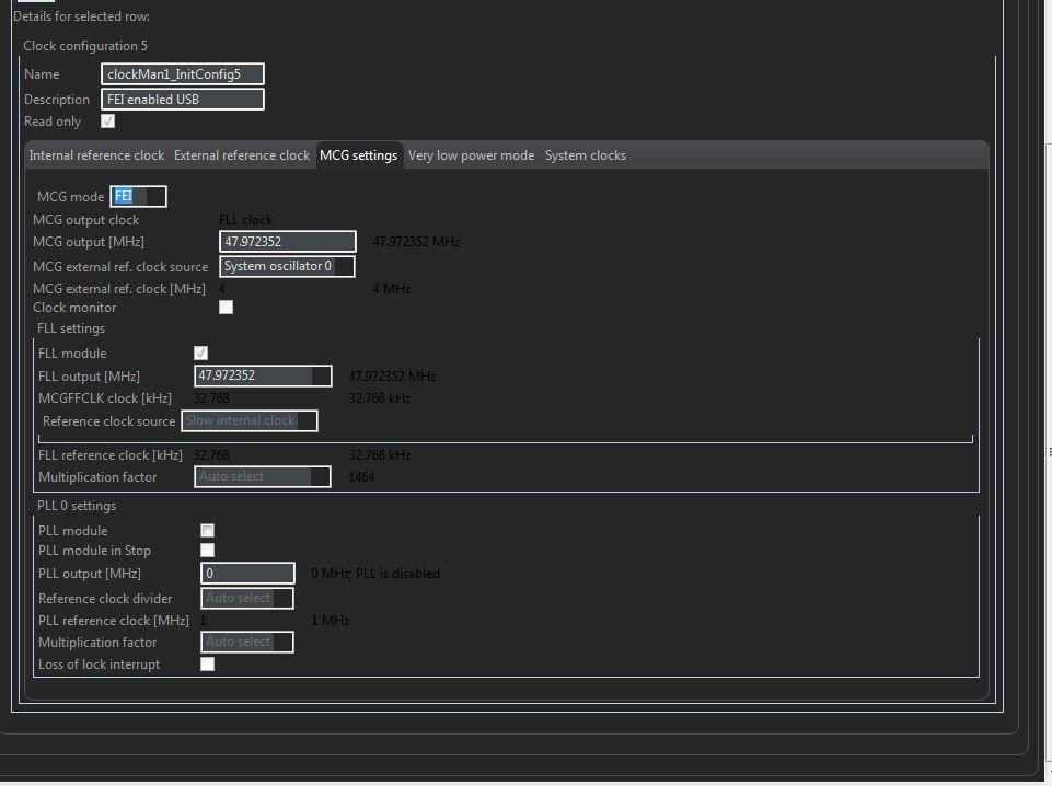

F50SC
Hi Mark
Thanks, those settings worked.
I've also enabled the serial_interface for debugging and to test the loader using SREC & Intel HEX file transfer modes.
I have configured the loader UART to match my hardware, and have the menu showing up in the console terminal.
The SD card functionality I have removed, but will look at this again later for SPI, once I confirm I can use my PC app and KinetisFlashTool to load an image using the Serial Loader.
Right now, USB is not enumerating, rather than a single "ding,dong" from Windows I get a double "ding,ding" and windows displays Unknown Device in Device Manager.
Could it be related to the clock settings?
Although I have a 4MHz crystal on my hardware, I'm not actually using it.
The current clock config I have is FEI MCG mode.....I remember now I had some issues getting USB to work.
However, the KBOOT 1.2 bootloader works just fine with USB on my hardware.
These are the clock settings I use in PE
I look forward to testing the rest of the loader once the USB is up and running.

mjbcswitzerland
Specialist V
Jerome
Your part needs the 4MHz crystal to correctly run from USB (it may work from the FLL but it will have high jitter and not pass any USB certification testing - although may work in the lab for quick tests).
The 80MHz setup is not suitable for USB because a 48MHz clock can't be generated (if you build and run the serial loader in the VS project the simulator will inform you of invalid clocks and show that USB can't work).
To use USB try the following settings:
#define CLOCK_MUL            48                              // the PLL multiplication factor to achieve operating frequency of 96MHz (x24 to x55 possible)
#define FLASH_CLOCK_DIVIDE   4                               // 96/4 to give 24MHz
#define BUS_CLOCK_DIVIDE     2                               // 96/2 to give 48MHz
Also ensure that the USB is using the internal clock:
#define USB_CLOCK_GENERATED_INTERNALLY                               // use USB clock from internal source rather than external pin - 96MHz or 120MHz core clocks are suitable
This will allow USB device operation (as would 120MHz core speed if you want to run the processor faster).
Mark

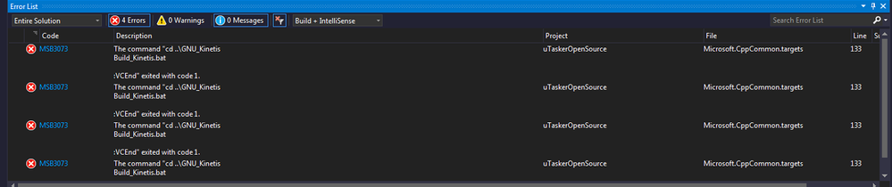

Regarding your simulator. I had some issues trying to compile on my work machine...the make file was failing with a generic error and I tried a few different uTasker projects I had on file and they both had the same error. Although I can compile and run the project successfully on my home PC. See below error..
At this stage, I can now connect using the KinetisFlashTool AND also my device config app, these are the some of the issues / comment I have thus far.

mjbcswitzerland
Specialist V
Hi Jerome
The simulator failure is a post build bat file that can't be execute - the simulator is still OK and operational.
There are two possible explanations:
1. You are using the "Kinetis" target on one machine and the "Kinetis plus GCC build" target on the other. The one not trying to do a post build step is then not showing the error message.
2. On one machine the post build step is working and on the other it is not (check the bat file called to see that it knows the path of your GCC toolchain).
