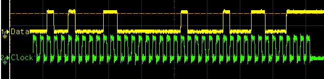

The transceiver uses 2 SPI: one as a Master device (microcontroller to transceiver) and the other as a Slave device (transceiver to microcontroller). It transforms the information received via SPI into a format using a differential transformer pulse format, as stated in the datasheet:
The diagram below shows the communication between the devices:
If a bit “1” is sent through SPI, it is translated into a positive phase sine pulse. If the bit is “0”, the pulse has negative phase:
These pulses are sent to the MC33771 via a twisted line pair. The messages from the MC33771 uses the same TPL to get to the transceiver, where they are converted to the SPI format and sent to the microcontroller.

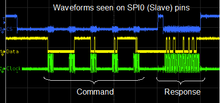

The following picture was taken using an oscilloscope measuring the SPI0 (slave) pins. Here, we can see the the data being transmitted and received from the MC33771. Because the command and the response share the same line, the command from SPI1 (master) is echoed to SPI0 (slave). The command and response frames have 40 bits each.
I’m sending the command READ to the MC33771, asking to read a register called SYS_CFG2. This command is composed by the frame 00 01 04 11 E8, in hexadecimal.
According to the MC33771 datasheet, when sending this frame, it is expected to receive a response composed by the frame 24 30 04 11 8F. Looking closely, that is exactly what the device is sending to the microcontroller:

The problem is, when I debug my program using Code Warrior, I see that the response variable is always missing the last byte, and the 4th byte has a strange behaviour. Sometimes it has the expected value, and sometimes it assumes the value expected for the 5th byte. The change in the value of the 4th bytes seems to occur randomly.
This behavior is not exclusive to the KEAZ128 controller. I used the KL25Z and had the same issue.
Does anyone have any idea what’s happening?

Hello Joao:
This behavior sounds like an overrun condition. See the next paragraph from the manual:
If this is what is happening some things you can try to fix it are:
- Increase the KEA core clock frequency.
- Use a lower SPI baudrate.
- Use a higher optimization level from the compiler. In particular optimizing for speed would help.
Your scope shows that all bytes of the response are transferred, but maybe the MCU eventually loses 1 byte. Try adding a global variable in the interrupt routine to count how many times it is triggered.

joaofracarolli
Hello Jorge,
I increased the core clock frequency and it worked! :smileyhappy:
Thank you very much
