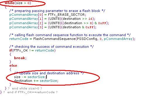

I'm using routines from C90TFS and working with TWRK60... I'd like to know what's the smaller size I can erase of the PFlash.... The routine FlashEraseSector has destination and size as parameters. Could I especify a word-aligned destination and size=4 and only erase those 4bytes since the destiantion address and leave all the rest of sector untouched?

The sector size is the minimal size for erase operation, and it depends on the device, as I know, for K20 50MHz part, it is 1Kbytes/sector, for K60 100MHz part, it is 2Kbyte/sector. so there is no smaller size for this api, the size parameter here should be sector aligned, otherwise an error code FTFx_ERR_SIZE would be returned.

I assume it was as you said, but the size parameter would be meaningless... Why passing an unnecesary parameter that would not only confuse but also return an error?

The size parameter is used to specify how many sectors are going be to erased, for example, if the sector size is 2K, and the possible size parameter could be 2K, 4K, 6K and so on. The API would check whether the size parameter is sector aligned, and determine how many sectors to be erased. so this parameter is not needed by FTFL module, but the driver code. Please refer to the following for details.

Now it make sense!
