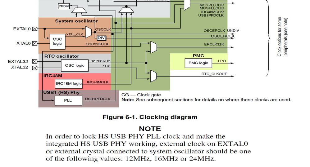

What are the minimum register settings to get the USBHS PHY PLL to lock?  We have a very clean 12MHz clock going into the PLL.

I believe we have our MCG set correctly.  I am following the updated reference manual information from section 55.3.2 which indicates what registers need to be touched.  I think there is one setting missing to enable the trim:
TRIM_DIV_SEL_OVERRIDE - Override enable for PLL_DIV_SEL, when set, the register value in USBPHY_PLL_SIC[1:0] will be used.
The PLL is still not locking.
Is there a favored frequency for that PLL (12 MHz vs 24 MHz)?  I expect to be giving it a clock (square wave) rather than a 12 MHz sine wave.  Is that correct?

isaacavila
Hi Sam,
According to K65 Reference Manual and in response to
is there a favored frequency for that PLL (12 MHz vs 24 MHz)?  I expect to be giving it a clock (square wave) rather than a 12 MHz sine wave.  Is that correct?
PLL's input clock should be 12, 16 or 24 Mhz so there is no favored frequency (12 or 24MHz) due you can use either 12, 16 or 24 MHz, and this clock signal should be a square wave rather than a sine one.
Besides, TRIM_DIV_SEL_OVERRIDE bit (bit 0 from USBPHY_TRIM_OVERRIDE_EN register) should be enabled in order to use PLL_DIV_SEL values (24, 16 or 12 Mhz).
Could you please send me your code for looking any missing configuration?

sam_
This was most certainly helpful; however, the key that made it work for us was stating that our bench oscillator clock was actually a crystal.  We have not been able to get the USBPHY PLL to lock without telling the K65 that the clock source is a crystal (the demo board uses a crystal).
5,495 Views
isaacavila
Hi Sam,
As you may know, design team confirmed this is a silicon issue, and they will create an errata for this.
As a workaround to your problem, maybe you need to pretend what connected is a crystal and that can make HS USB PHY to work.
Isaac
