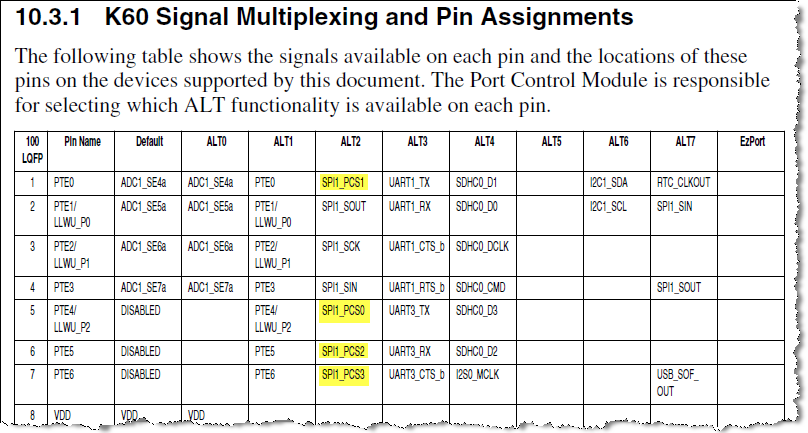

ilginsarican
I use MK60DN512VLL10.
I have to use at least 65 ADC data, probably I will use ADS1158 16-Channel, 16-Bit Analog-to-Digital Converter.
I want to know that How many SPIs can hardware connect to the processor's SPI port?

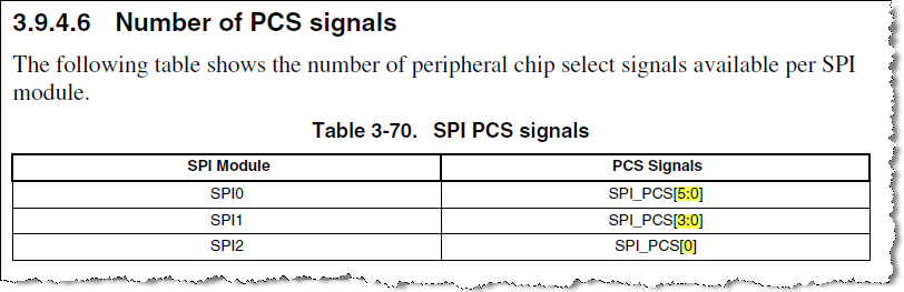

There are three SPI modules on MK60DN512VLL10.
According to the "Table 3-70. SPI PCS signals", you can see there are:
6 PCS signals for SPI0
4 PCS signals for SPI1
1 PCS signals for SPI2
Please read "10.3.1 K60 Signal Multiplexing and Pin Assignments" and check if you can arrange all these PCS signals at the same time on your board.
