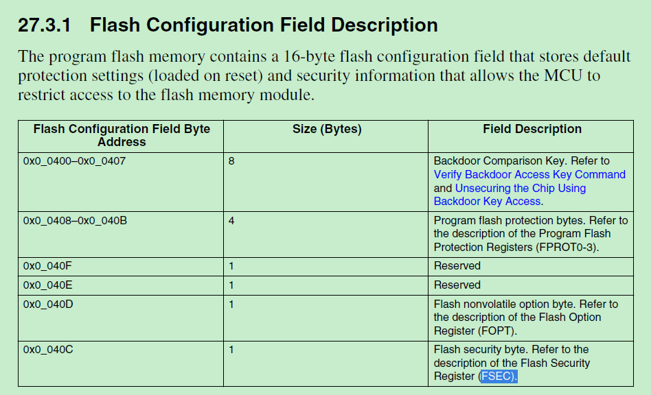

Could you post the KM34 debug interface schematics for double check?
And please provide the Flash configuration Field Value also.

kalpesh_dodiya
Here, I am not able to upload interface for Debug image.
Message comes "You are not allowed to create or update this content"
BTW,
FSEC value : 0xFE

Hui_Ma
The FSEC value 0xFE means KM34 is unsecured and debugger isn't blocked.

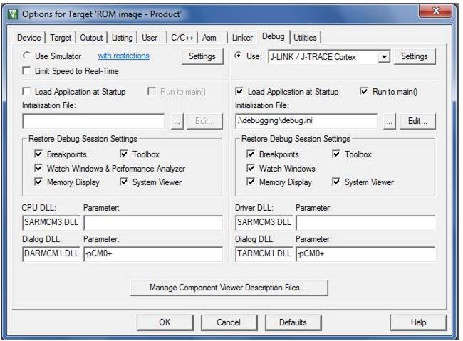

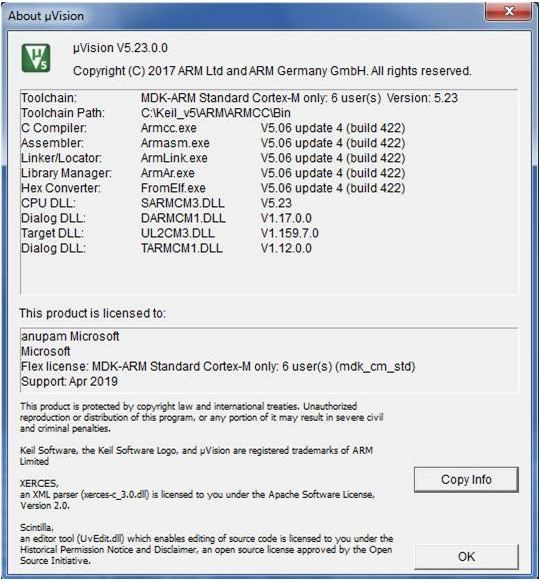

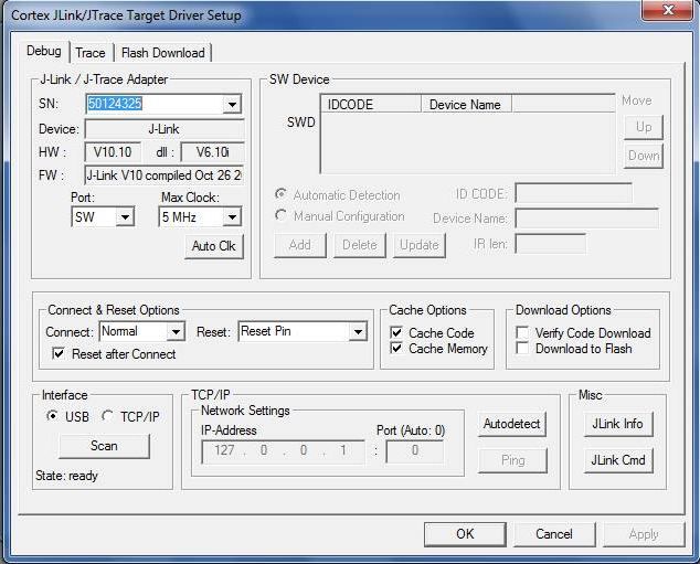

You mentioned debug the code, so which IDE software are you using?
Could you post your IDE debugger panel setting for double check? Thanks.

kalpesh_dodiya
Hello Mike,
I am using Keil V5.23 and debugger settings snapshots are attached here.Capture1.JPG

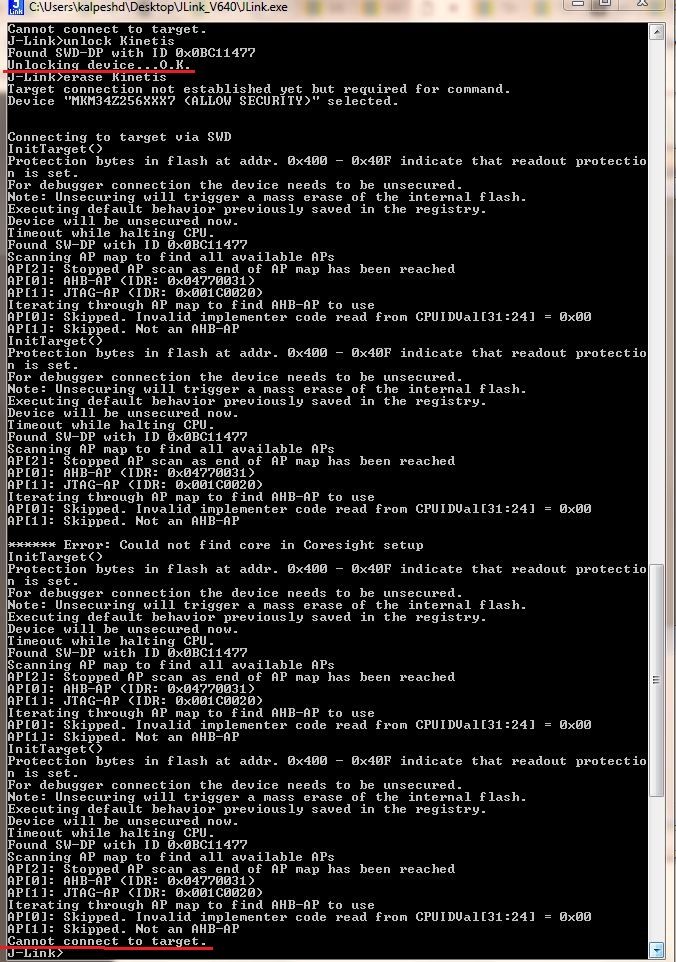

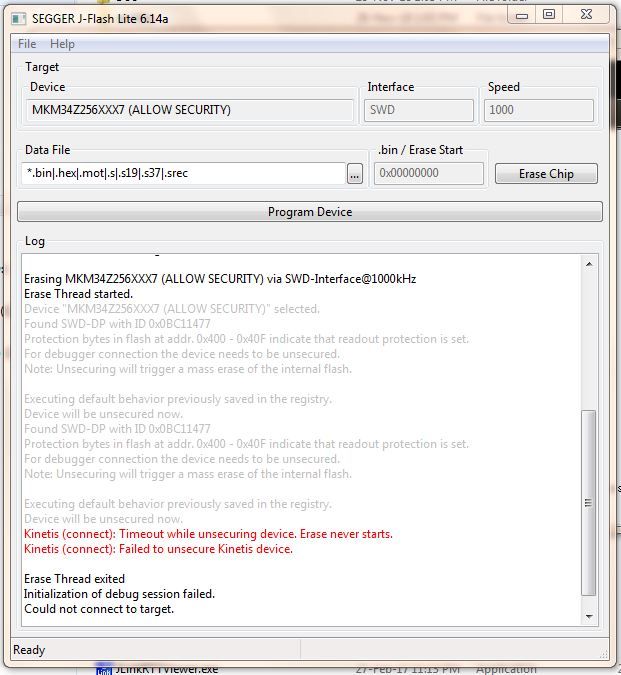

I have analyzed and found,
In some of units I able to unlock the Micro controller but just next if I connect the board to J link debugger to reprogram, it shows the message “cannot connect to target”.
Later I think to erase the chip using “erase Kinetis” command through jlink.exe (command window) but it shows timeout while halting the CPU and couldn’t connect to target. If you can interpret the logs then we can solve the problem. For reference I have attached “Unlock OK_Erase Not OK.jpg” here in attachment.

Hui_Ma
Please try with attached J-Link script.
The Kinetis Kxx Cortex-M4 erase all and unsecure manual in Chinese, I add the translation for your reference.
I think this J-Link script also be suitable for ARM Cortex-M0+ core.
Wish it helps.
