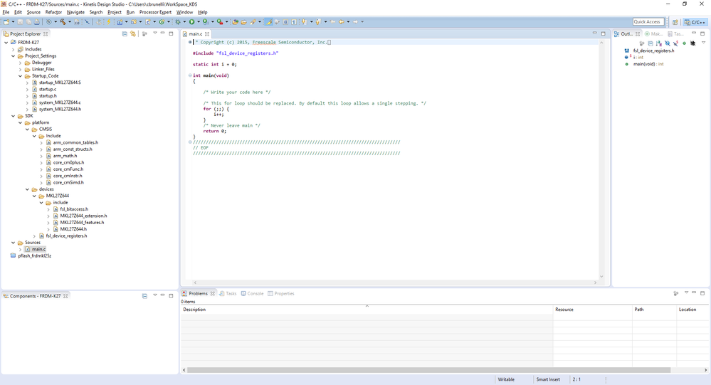

But in this case I think I have a wooden head. I'm not very familiar with sdk. As I wrote for sdk about K25, when I want to import a new existing project in KDS ide, I could see different type of project and choose one of them.
pflash_frdmkl25z in my case. And start to write my app from there.   And it's great for me this example project because I want to use the sdk only for the flash used as eeprom. For other peripherals I have already have my custom library.

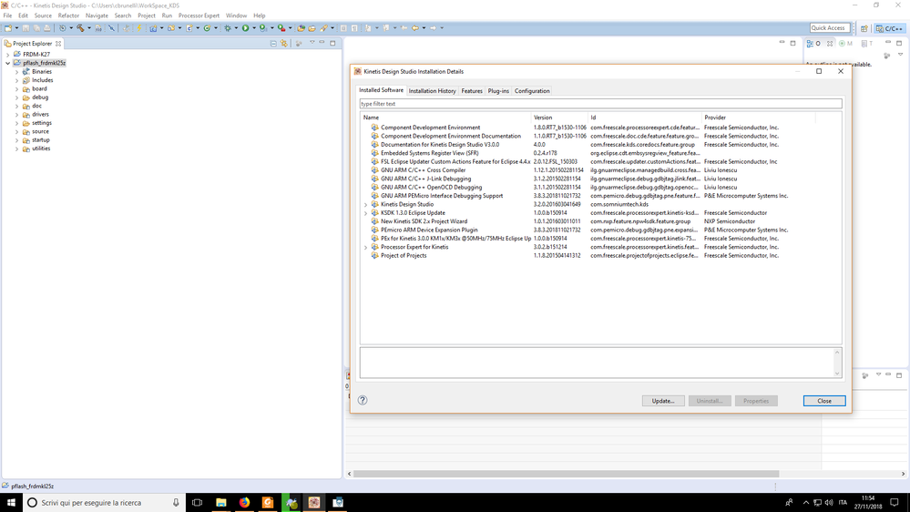

So, I start with a new project base on FRDM-KL27 (with the target will be K17 processor)  trying to import the necessary file but it doesn't compile at the end.As you wrote me I tried to use the suggest folder but I can't see any project to import.
I don't know at this popint. For My kds configuration see the attached file, just to try to help me.

A project as I found for K25, based on K27(just to use the freedom board) it's ok. So I can see well what happen about flash storing and use only what I really need and, also, to be able to better follow the flow of the code.
As I wrote it's a bit difficult to start with an empty project (like I posted) and insert step by step the right source and include file. Something is always missing and the compiler is crying for error.
