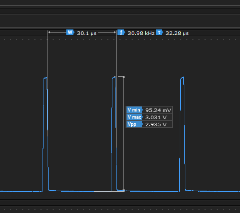

I'm using Kinetis K28-FRDM and SDK 2.3. I have a test application where I want to feed the DAC at 500kHz sampling rate using eDMA and PDB modules.  The data to be converted is a large pre-stored buffer in RAM. So far, I am able to do so only if  I transfer 16 words (size of DAC data registers) at at time, and manually increase the source pointer and setup a new DMA TCD for every 16 words in the eDMA callback (interrupt). But what I would like to achieve is to setup the eDMA, PDB and DAC to convert the entire source buffer without the need handle the eDMA IRQ every 2 x 16 us. It leaves very little time to do anything else. That should be possible or what ?
If I change this that works :
/* DAC_DATL_COUNT  = 16 */
EDMA_PrepareTransfer(&m_transferConfig, (void *) (s_dmaBuffer), sizeof(uint16_t), (void *) DAC_DATA_REG_ADDR, sizeof(uint16_t), DAC_DATL_COUNT * sizeof(uint16_t), DAC_DATL_COUNT * sizeof(uint16_t), EDMA_MemoryToMemory );
to :
#define SOURCE_BUFF_SIZE 1024*16
EDMA_PrepareTransfer(&m_transferConfig, (void *) (s_dmaBuffer),sizeof(uint16_t), (void *) DAC_DATA_REG_ADDR, sizeof(uint16_t),DAC_DATL_COUNT * sizeof(uint16_t), SOURCE_BUFF_SIZE * sizeof(uint16_t), EDMA_MemoryToMemory );
...there is no eDMA interrupt and DAC output is 0 v all the time (major loop > 1)
If I change EDMA_MemoryToMemory  to kEDMA_MemoryToPeripheral,  the eDMA interrupts come as expected when the entire source buffer is completed.  The source pointer is automatically increased in-between by eDMA,  but it seems that only the first DAC data register is converted, the rest (15) are all 0v.
What did I miss ?

eldarfiring
Thanks a lot your reply Mark !
I did the same setup as you suggested, but with same result as before. So I now think the DMA/TCD part is OK.
If I understand your setup correctly, you are not using DAC data register buffer (DACBFEN=0) and the converted data is always the first word?  If I do that, I get no DAC output what so ever.  Can I ask you what setup you used for DAC / PDB ?
If I enable DAC buffers (which I believe is wrong with current TCD setup) I have output like the picture (it's suppose to be a continuous line, but it raises for DAC data register 0, and drops down for DAC data registers 1-15 I guess). That makes sense.
For the PDB I am using DAC interval trigger enabled (external disabled).

eldarfiring
Hi Mark,
Thank you for your reply! I have now figured it out. As you indicated, I could not use DAC to trigger the DMA (also since DAC buffer mode is disabled).
Instead I use PIT0 :
#define DMA_CHANNEL 0U
/* Configure DMAMUX */
DMAMUX_Init(DMAMUX_BASEADDR);
DMAMUX_SetSource(DMAMUX_BASEADDR, DMA_CHANNEL, 60 ); /* Map to always enabled source */
DMAMUX_EnablePeriodTrigger(DMAMUX_BASEADDR,DMA_CHANNEL); /* use periodic trigger mode - DMA Channel 0 - PIT 0 */

I'm now transferring the memory buffer to DAC at high speed (~1MHz), and it works fine. The CPU has plenty of time to do other stuff.
Thanks again!
Eldar
