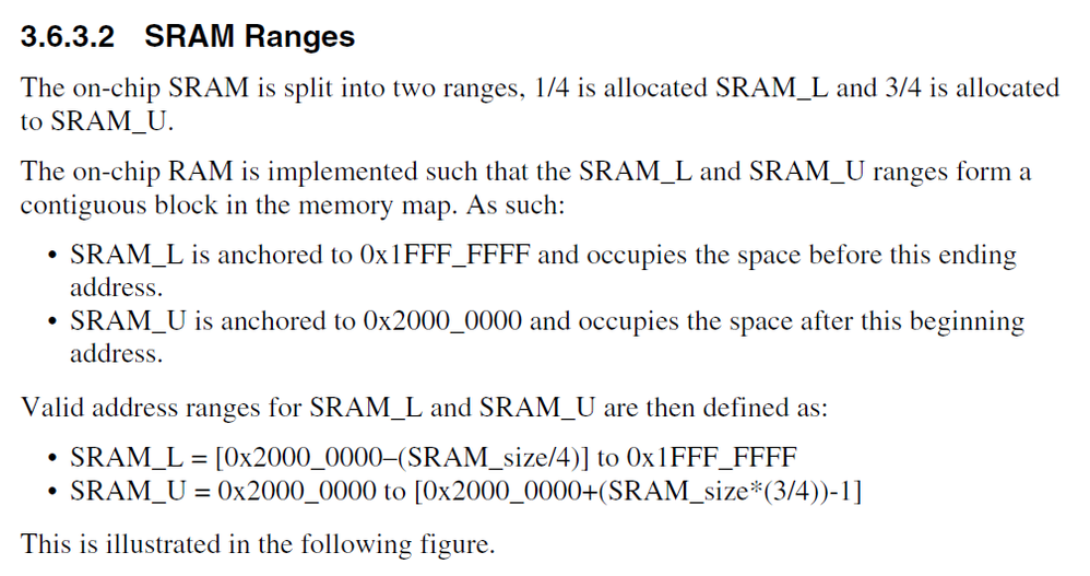

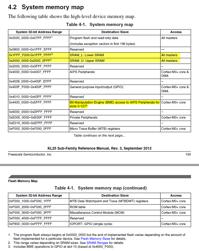

Can someone tell me where is the document that shows where is the location of the SRAM e Flash in memory map from the microcontrollers MKL25128?

     About the memory map, for the detail MCU based on the ARM core, you still need to refer to the according MCU user manual's memory map. So, about the KL25, please refer to the reference manual's memory map:
About the SRAM, if you run from the SRAM, it can be used as the code run area, in this mode, if the chip is power off, the code will be disappear, but the program area, normally means the flash area. Even the KL25 SRAM_L is in the ARM's document program area, but it's still the SRAM. Program area normally is the flash area, not the SRAM area.

Hi Matheus Pinto,
   Please refer to the KL25's reference manual:
https://www.nxp.com/docs/en/reference-manual/KL25P80M48SF0RM.pdf
page72, chapter 3.6 Memories and Memory Interfaces
Wish it helps you!

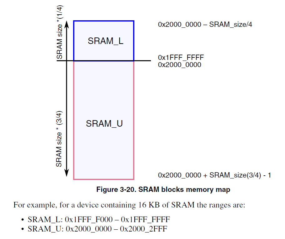

I have one more question: the range of the SRAM for MKL25128VLK4 is  0x1FFF_F000 – 0x2000_2FFF. However the ARM Cortex M0+ reference manual shows that the space dedicated to SRAM is above 0x1FFF_FFFF.  The SRAM_L range 0x1FFF_F000 - 0x1FFF_FFFF is not inside the program space?

   I don't know why you say: However the ARM Cortex M0+ reference manual shows that the space dedicated to SRAM is above 0x1FFF_FFFF.
      From the reference manual, you can find these information:
Just have two ranges, both range can be used as the program space.
Wish it helps you!
If you still have question about it, please kindly let me know!
Kerry

In the page is show that the space below 0x1FFF_FFFF is from code region (i.e. flash). But from the KL25Z manual and from what you show, the SRAM_L is in code region (0x1FFF_F000 - 0x1FFF_FFFF). This does not seem consistent with what is presented in ARM.

I know that SRAM is data and Flash is code. I was confused by the information passed by the "ARM Center" that conflicted with the microcontroller manual. I did not know that the manufacturer could put SRAM in an area where the ARM says to be reserved for program.

    You are welcome, for the specific chip, you still need to refer to the chip manufacturer's document.
